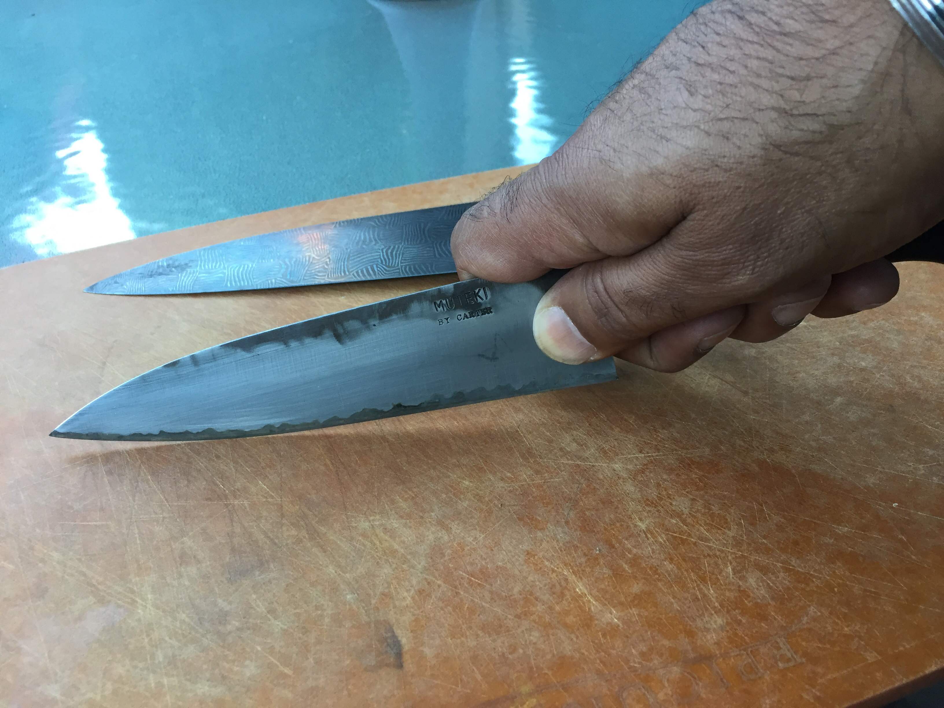

I just checked out his "101 Knife Designs" book (literally, from the library) and the thing that stood out for me is that his kitchen knives seem very short to me.
I learned to make sure that on a kitchen knife, to make sure it's tall enough (or the choil is high enoough) so that your knuckles don't slam into the cutting surface, and with his designs, that would be impossible.
Any thoughts?
Only if you have huge knuckles and don't account for the angle that the blade meets the board. The small funayukis in the 5-5.5 inch range on his website are all like 40mm at the heel.
Your question is pretty broad. Which kitchen knives specifically are you looking at? I've made several kitchen knives out of that book and there are no problems.
- Chris
short as in the blade length? or short on the heel height?
I think you might be painting a broad design definition with your view,
personally I like a tall heel height myself, 54 mm or so
but I have a Carter knife in a style that I will call a cook's knife that is very versatile in the kitchen
It's called a Funayuki however.
At first I didn't like the size and it's not tall on the heel, but it's a great knife that is light and useful
I think it also depends on how you use it, how you hold it and what you are cutting.
regards

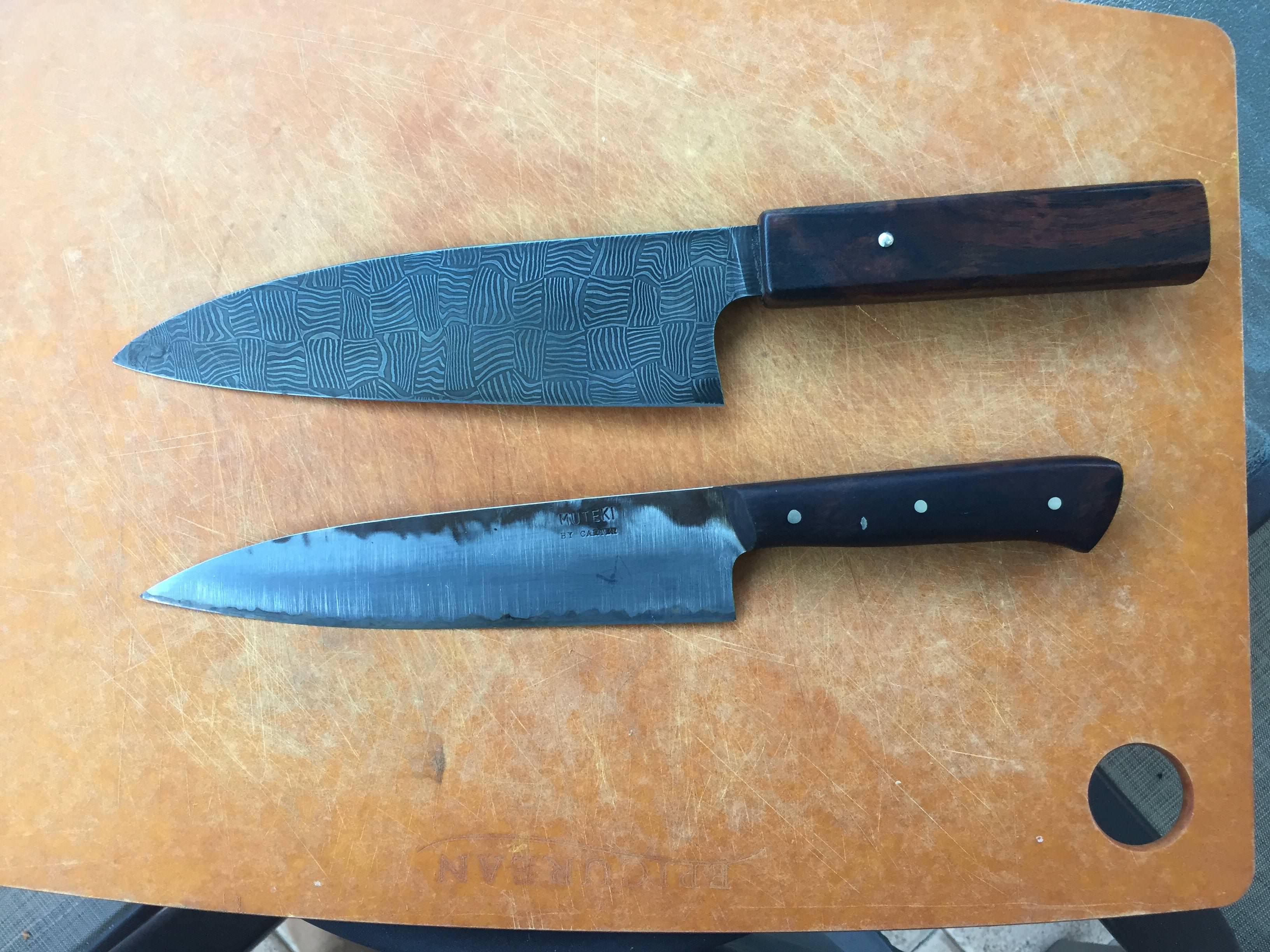

see if this helps, the top is my knife, the smaller one a Carter
The Carter looks like a petty. Oversized paring knife. It's not supposed to have a 50mm heel height.
