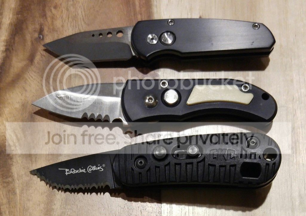

I'm referring to my CKC 103 (bottom knife).
Absolutely love this little usefull auto however, the pocket clip number one, is not long enough and two, it is held in place by one hex screw.
It either starts climbing outa my pocket or twists around in my pocket.
Any thoughts? Two screws would do the trick.
Without a doubt, a poor clip design for a better quality knife.
Can't give suggestions without seeing the clip side.
Same exact knife, only different blade. Same clip exactly.

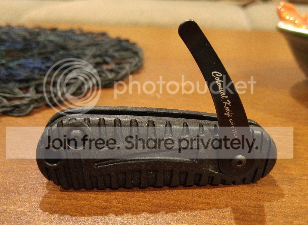

Ok, well here is my knife with it's ridiculous swing crap pocket clip in action.
I'm about to just take it off and carry it in my pocket.
I'm going to contact CKC and at least see if they'll consider my advice for improvements.

Ok guys, some more great suggestions. Yeah, this knife is down to $50 now but obviously made by someone that never uses it. What I think I'm going to do is use this epoxy I used once before that is for metal or plastic and it's wickedly strong stuff then use killgars suggestion of the little rubber washer as added enforcement.
crom, that's a Protech Runt. Made 15 miles from me along with other bigger blade autos, none of which we can legally own in California.
