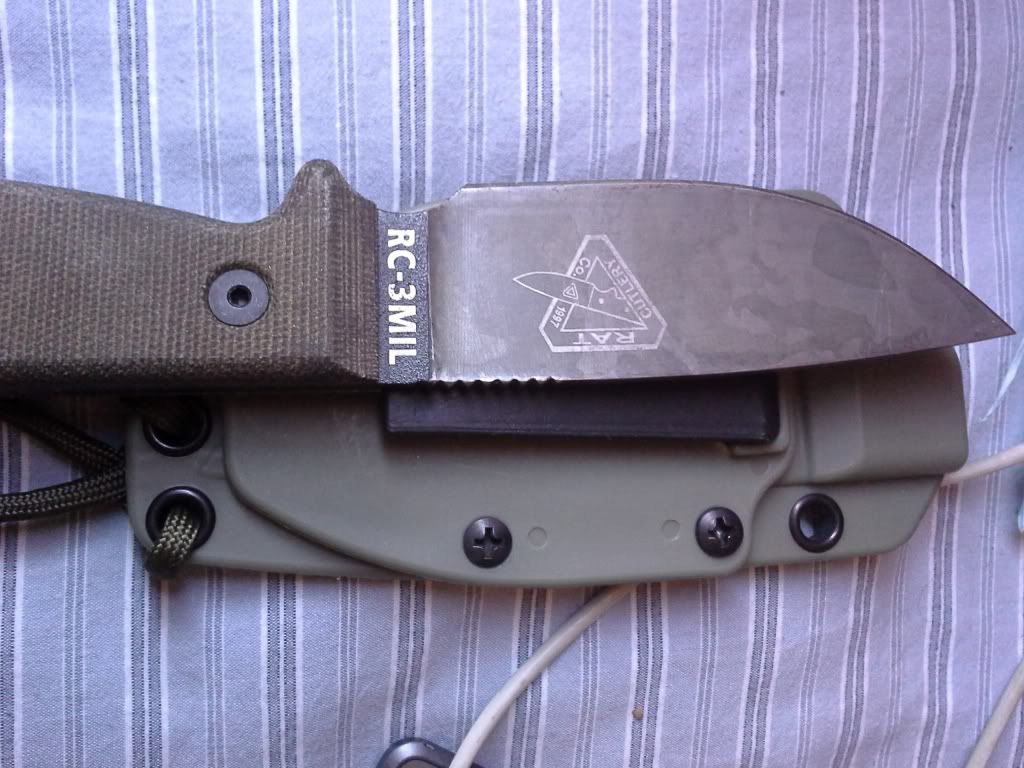

So I've been stripping all of my knives for a few years now with perfect results....My question is, how do I go about stripping the blade but not the handle tang?
I've yet to do this and I was trying to think of a good way, I use Jasco btw. I want to strip the blade but leave the coating on under the handles on this next project.

Suspend the blade in the stripper from a string. Maybe paint over the handle with something that won't strip and sand it off after.

I was thinking about painting the tang but suspending it sounds like a great idea also!
thanks for the suggestion.
I use blue painters tape on my Beckers. It will seep under a bit. I will often cover less than 1/16" with tape over what I want to strip and let that area be the sacrificial lamb. I sometimes have to touch it up with sandpaper, but my resulta have been acceptable to my knife ocd.
blue masking tape

Like said above, though, it can seep under a little and leave you with a less than perfect line needing a touch up. If you care about things like that
Just put a rod through the lanyard hole, find a suitable height glass jar and suspend the knife into the stripper for a good clean line. When you pull it out dry the excess right away.
