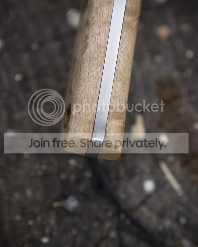

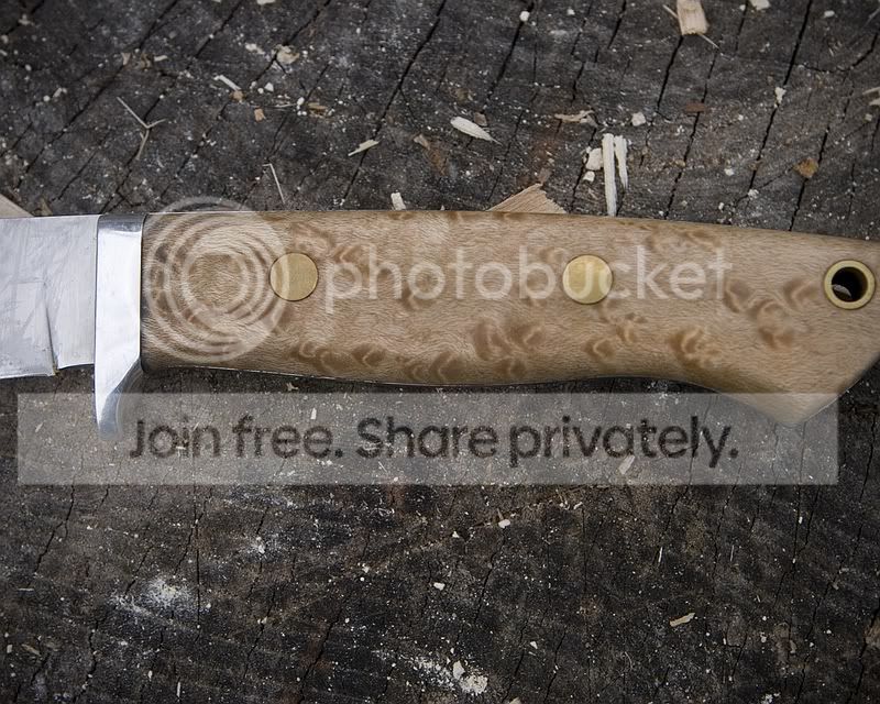

Let me first say, that it is not going to be hard to recognize who makes this knife. But, this is nothing about that. The particular manufacturer is excellent.
This is more about the issue of wood on steel in a full tang design. Whether the wood is stabilized or not, the expansion/contraction rates between it and steel are significantly different. Therefore, over time, I think there are bound to see some of the issues shown below.
The real question is, does it bother you?
This first one, you can already see the handle shrinkage, and steel above and below the handle.

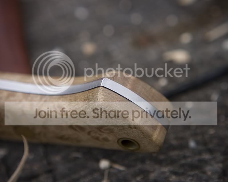

And also gaps from wood changing.

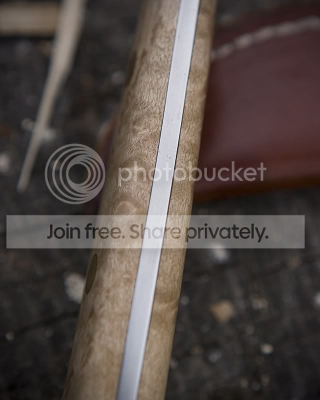

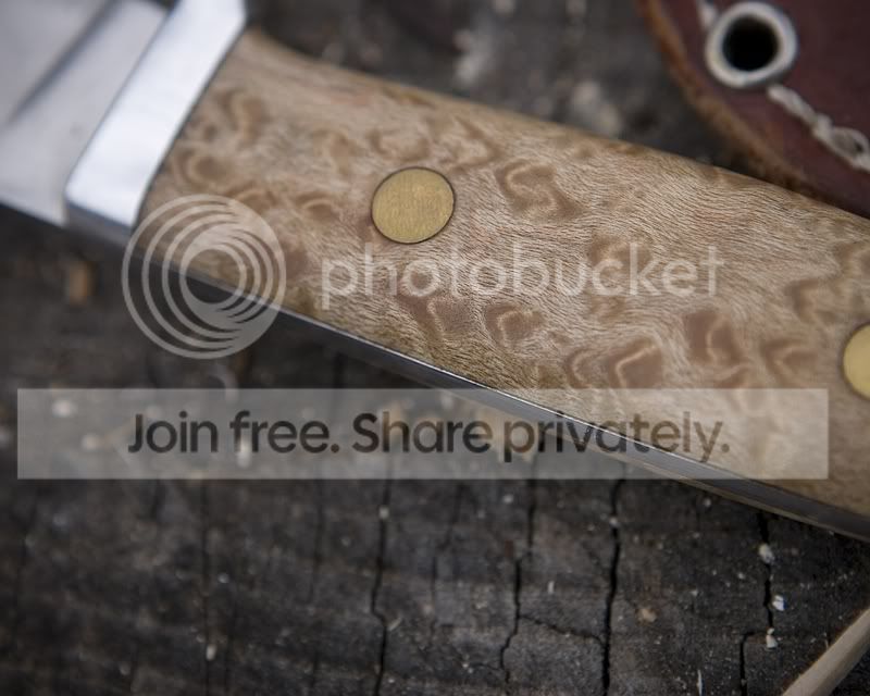

More protruding steel.

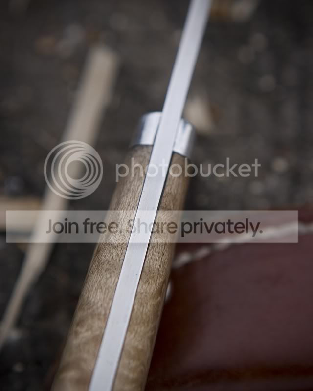

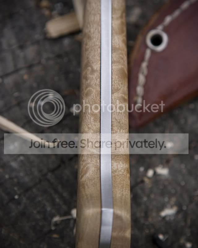

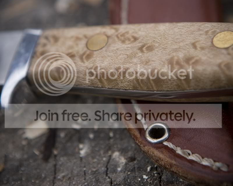

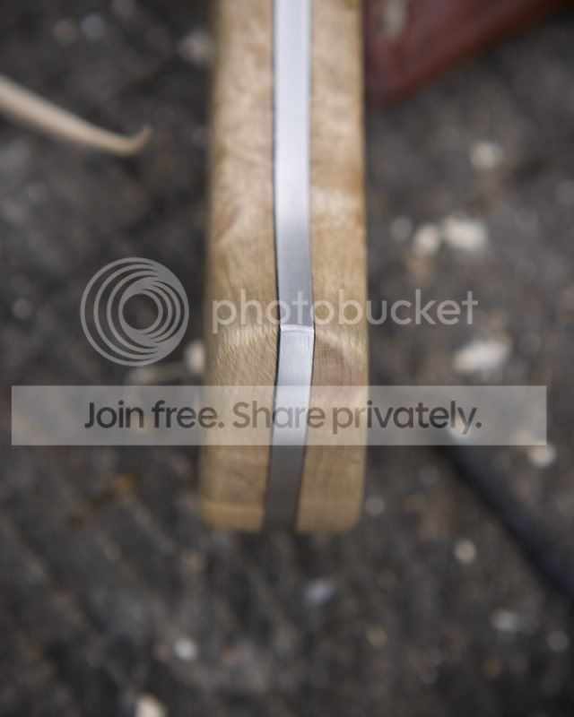

More gaps.
Making knives myself, I am super anal about the fit being there, no gaps, etc. I also love wood handles. But, I still can't help but wonder what could happen years down the road. That is why I posted the question.
Is it enough to sway you from wood? I know micarta/g10 is great and all, but it just doesn't have the same warmth, feel and look of wood.
I don't want this to be a negative post. I think this is about the physics of something that is bound to happen, and that can not really be changed (I think anyway, maybe someone else can shed some light on it). And and I am just trying to get thoughts and opinions.

I gotta tell you Brian - this happens with Micarta knives too. My BRKT knife came PERFECT from the factory in terms of matching - and there is some shrinking in the handle. Nothing like above - bit you can see it.
I think that WHEN I am staring at it - it bothers me. When I am using it - it doesn't.
I can feel it with my fingers - not my palm. I think the harder and more stabilized the wood is - the less that happens. I do think, however, that as much shrinkage as you have above could have been prevented through greater curing before handling. I would send the pics to the maker and see if they are willing to touch up or rehandle the knife for you.
TF
Different woods are going to have different shrinkage. The tropical rosewoods and cocobolo are going to be very stable, where the American hardwoods like maple and oak are going to be needing a weekly rubdown with some linseed oil. I think the Grohmans use rosewood.
That birdseye maple needs a good rubdown every week. There's no wood handle that had the durability of synthetic materials.
for that kind of money, I'd be very upset and send it back for a refund. It's a shame because the wood is very nice.

That can happen with micarta too! Not nearly as bad as that but it does. Maple is one of the worst woods for movement, even stabilized maple is prpbably not as stable as natural cocobolo IMHO.
