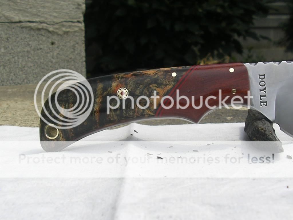

Larry,
I had the same problems when I first started stamping. The steel should be annealed yes, but you are eally kidding yourself if you are trying to stamp without a press. I use a hydraulic press because I have access to one but an arbor press will work if you don't. many times no straightening needed at all and ALWAYS a perfectly crisp,centered stamp of equal depth on all letters.
You really need to try it and quit praying you don't ruin your blade with an offcenter stamp of even depth. I was ready to throw mine away also but quite pleased now.
Matt Doyle
