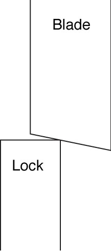

Hi all,
I got my first framelock knife (Southard Tolk).
When I looked at the contact between the lock bar and the blade, it looks like the Ti lock bar secures the blade only with its edge.
I can't take a picture of it, so providing an illustration.
My question is whether this is normal, or something I should be concerned of.
I would appreciate your opinions.
Nevertheless, the blade is locked solid, and there is no play. I also tried the STR's lock test, and it withstood the pressure well.
Miso
Yes, very normal and within time and use it may set up with more of the frame lock positioning itself further along the knife.
For the best strength, in theory, the lock face should only contact the blade at one POINT, i.e. it's not intended that the lock face contact with the blade should be along its entire surface. The opposite in fact It should only touch in a very small area....one point, not a lot of contact area. Exactly as your sketch shows.

Should it be a point or a line (side) for the contact?
Miso
In theory, a point...but don't eat yourself up over it. It's probably fine even it it looks like the whole 'line' is making contact. The Southard is a good knife.

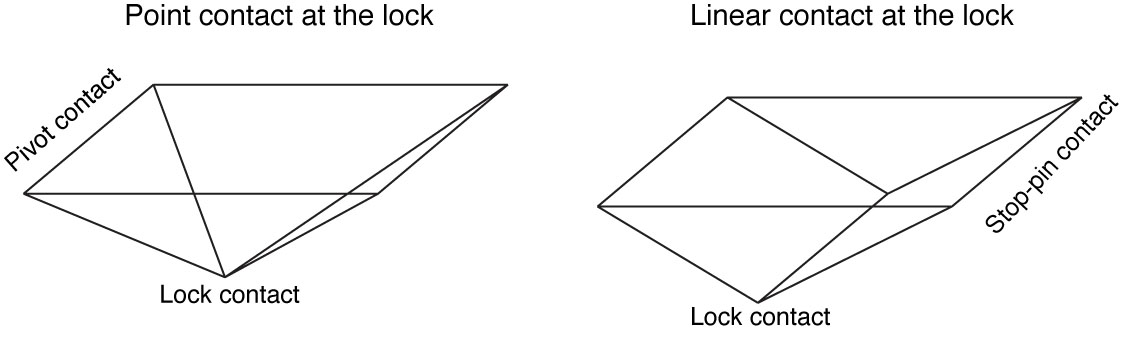

EChoil,
Thank you for the explanation.
I am pretty comfortable with the lock security of my Tolk.
I am just curious.
What I am comparing here are two types of putative contact at the lock.
To me, the configuration on the right seems more secure than that on the left, if all three contact sites are perfectly executed.
Since the pins and the cut faces of the blade can be virtually perfectly straight and flat, the contact lines at the pivot and the stop-pin could be almost perfect.
In contrast, the lock face of the blade is ground with an angle, it might be little difficult to make a perfect line contact there.
If not perfect, the blade may have a play.
But a point contact can be made much easily, and with the perfect line contacts at the pivot and the stop-pin, the left configuration can be both secure and play-free.
I think that a line contact would be ideal both in the strength and limiting wear.
A point contact would cause more wear because the force is concentrated to a small area.
We can see this kind of wear on the blade face where a detent ball runs.
So my guess is that the point contact is more executable without having a blade play.
Please chime in.

That is not what I meant.
Looking at the lock contact site of my Tolk, I realized that the lock bar touches the blade at its corner rather than its side.
So, it looks more like a point contact you described.
Then, out of curiosity, I wondered if the lock bar should hold the blade with its entire side.
That was what I tried to illustrate and compare.
Anyway, another potential benefit of a point contact is to minimize lock stick.
Miso

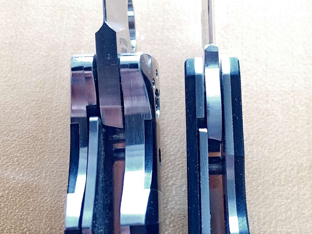

:D But wait ! There is more! There is also Terzuola's modification of the Walker's lock where the lock face of the blade is actually curved...
Vallotton on the left, FOX terzuola on the right:
As seen I n the top pic, a quality knife should have the lock bar cut out at an angle so as to mate with the blade tang with all overlapping surface area. In the bottom pic, it is theorized that only the bottom, farthest part from the pivot, or from this angle, the rightmost points of the lock face and tang should meet.
IMO your knife is not made ideally, but it will
pass.
Edit: That's one gunky looking Sebenza! Haha.
