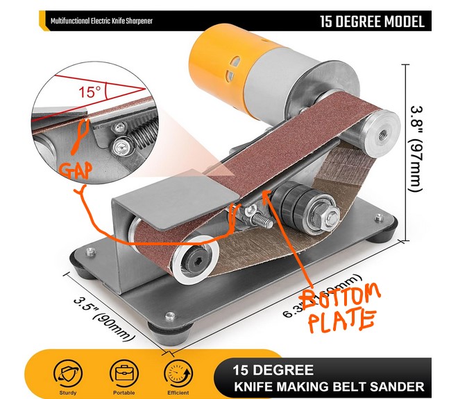

I just bought my first belt sander and I don't exactly know how to use it. This is the picture.
My question is when I push the edge of the knife towards the sander belt, how hard I push?
As seen in the picture, there is a bottom plate right underneath the sander belt. There's a littl GAP between the belt and the bottom plate. Question is when I push the knife over ( horizontally ), do I barely let the edge touch the belt without pushing the belt all the way to the bottom plate? Or do I push it hard enough so the belt actually touch and glide on the bottom plate?
Thanks
Alan
I could be wrong but it looks like you can adjust this bottom plate to touch the belt.... two screws beneath the plate.
Anyway, start slowly.... don't use too much force and see how it goes. Use a cheap knife for a test.

Thanks, that's my first thoughts to adjust the bottom plate to be closer to the belt. The sander absolutely do not come with any instruction. This is a low price sander used by first time people. They should give a little more instructions.

Go easy ,don't use too much pressure and don't linger in any one spot for very long. Like others have said adjust the flat part under the belt "plate" up so it touches the belt evenly. Running the belt towards the edge might be more likely to catch and cut the belt , so away is preferable. Marking the edge with a marker is a good suggestion also , it will show you more easily what it happening after each pass. Do you have a few different grits of belt? You shouldn't have to use the course ones very often unless there is edge damage or you are changing the angle you want the edge to be. I use a 1 inch by 30 inch belt sander to reprofile new knives and to change edge angles mostly and then either a fine stone or strop or even my Spyderco sharpmaker to finish the edge.

what is the optimal gap between the belt and the bottom plate?

The platen should be right up tight to the belt unless you want a more convex edge, it will eventually start to wear because the backside of the belts are kind of abrasive, it should take a while. A stropping belt will give you better finishing results than the steeling rod you have if you can find one that fits your sander. It is very good that you have some cheap knives to practice on.

Thanks so much, I adjust it closer already, maybe I should get it a little closer again. I really like the flat edge. I am taking my time, not rushing and experiment. I have enough junk knives.
