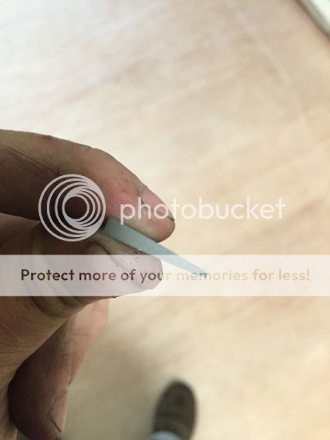

Here is what I used for my test knife:
Normalized using 1600 air cool to black, 1550 air cool to black, 1500 air cool to black then quenched in Houghton K
5 minute soak at 1485 then quench in 90 degree Houghton K
One hour snap temper at 400
Sub-zero overnight (dry ice)
2 x 415 for two hours
Flame draw spine to blue with edge in water two times
I have seen switched to Houghton G for this steel as I have cracked two knife in the Houghton K with steel.

Here is also a photo of the grain structure from a blade tip I snapped, this is right out of the quench
