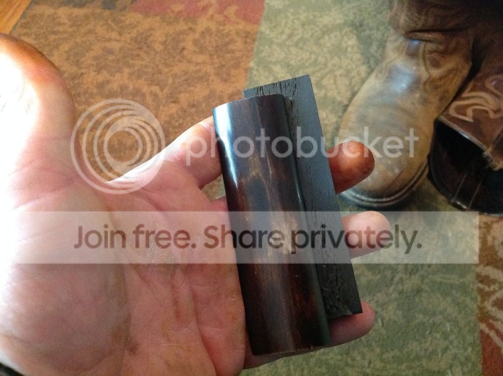

I bought some dyed camel bone the other day for a couple knives I'm working on. They are blackish or really dark brown. After I got them glued up and started grinding them almost all the color is gone and now they are splotchy brown and mostly white. My question is, is there a way I can dye them back to some extent with them attached? Can I soak it in leather or wood dye while attached? I'll see if I can get some pictures up later. Thanks.

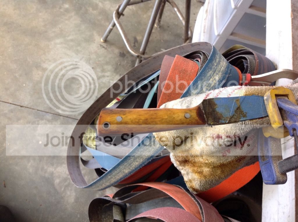

So I tried leather dye. I soaked it for 8 hours or so with not much luck. What about putting the whole knife in dye under vacuum?
What do you mean no luck? I haven't had much not staining something with leather dye. It'll stain greased Teflon.
I mean it's not taking much color at all. It is only a couple thousandths deep. I hand sanded it to 220 and soaked it. After a couple strokes of 400 it's already showing white. I can brush on the dye and let it dry and get the look I'm wanting but it's just on the surface and I'm afraid it won't last.
Edit: I'll check with the supplier to see if maybe it was stabilized and that's why it not taking much color. Heck by now I could've already removed them and put another set on but it's kind of a challenge at this point and I'm pretty stubborn.
If the camel bone is stabilized, it won't absorb much dye now.
I always found the outer surface color of commercial dyed camel and giraffe bone scales was very different than the inside when ground down. The color comes back a bit when the bone is sanded to a fine grit and then buffed well. I found that the black finished as a mottled blue-gray and the brown finished as a mottled tan.
This is after all my dyeing attempts and while it looks ok, not as dark as I'd like, a little rubbing from a fine scotchbrite pad to clean the bolts and tang it takes most of my color away.
