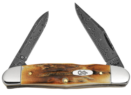

I'm looking at buying the new Case Damascus Humpback Half Whittler. I'm trying to find out if the blades share a single backspring or not. Does anyone have experience with this pattern? Any help is appreciated.
I'm pretty sure it's one spring. That's a primary selling point for most or all 'half' whittler/congress patterns, as it makes the knife much slimmer in the pocket. In the pic above (borrowed from a vendor site), it does look like a single spring.
I suppose it is possible that it is a single spring, but the Humpback Whittler is a three spring, so I would guess the half whittler is a two spring. I haven't seen one, though.
I saw that pic David and it looks like a single spring to me too. I was hoping to get that confirmed as that is what makes the knife attractive to me. Jack the three spring Humpback is what made me wonder too.
A 3 spring knife is not a Whittler regardless of what the marketing team wants to call it. The above "Half Whitler" should properly be called a Swell Center Congress with a Clip blade, but that's rather cumbersome.

2 springs it is. That's an eye-opener for me.
Looks like Case has opted for greater strength/durability (wonder how strong/stiff the springs are?), over the slim/light appeal that I'd otherwise assumed was a big draw to this pattern. Shouldn't have to worry about crinked blades (or blade rub) anymore, either. Interesting.

The tradeoff is that when they go to the spring-per-blade design, the springs and blades are all somewhat thinner than a single spring design would be -- so, no, they don't get any greater strength or durability - it's purely an expedient, simple to assemble design requiring much less skilled labor to do properly. This is also true for their older 3 blade/2 spring designs with crinked blades that are converted to three springs - the originals had thicker blades and springs.

I have a 10347 Case stockman with the 3-spring config. I did notice those blades are thinner than what's found a comparably-sized 2-spring stockman.
Thanks for the info and discussion guys. I guess this one gets scratched off the my wish list. I would have jumped on it if it were a single spring.
