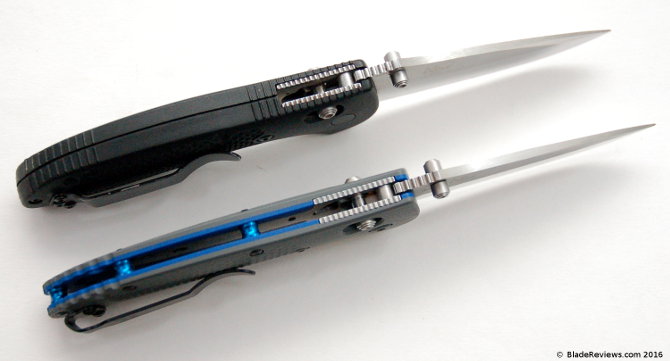

I'm just curious as why Benchmade makes the g10 Grips with the open back? Even on their site if you do the custom Grip the g10 one have the open back. Anyone know why? Not that its really an issue I'm just curious. I personally prefer the close back like the regular Grips but think the G10 tan on their site looks great.

Manufacturing. G10 is machined instead of molded like the standard handles. If they were to include the small bit of material that closes out the back, the blank (the original piece of material that they start the machining process with) would have to be as wide as half of the knife and then all of the material in the middle machined away. It increases material cost, machining time/cost, and scrap.
