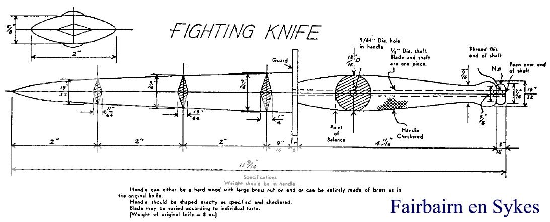

Hi Guys,
I'm making a FS Dagger, but never having seen or handled one, all I can do is go by pictures. My question is, how wide is the blade? It doesn't appear to be more than 3/4's of an inch wide. Hoping one of you collector fellas can help.
Thanks,
Dave
Does this help?
Kind regards,
Jos
Jos,
I've been all over the net and never saw that diagram. It certainly does help. Much thanks,
Dave
