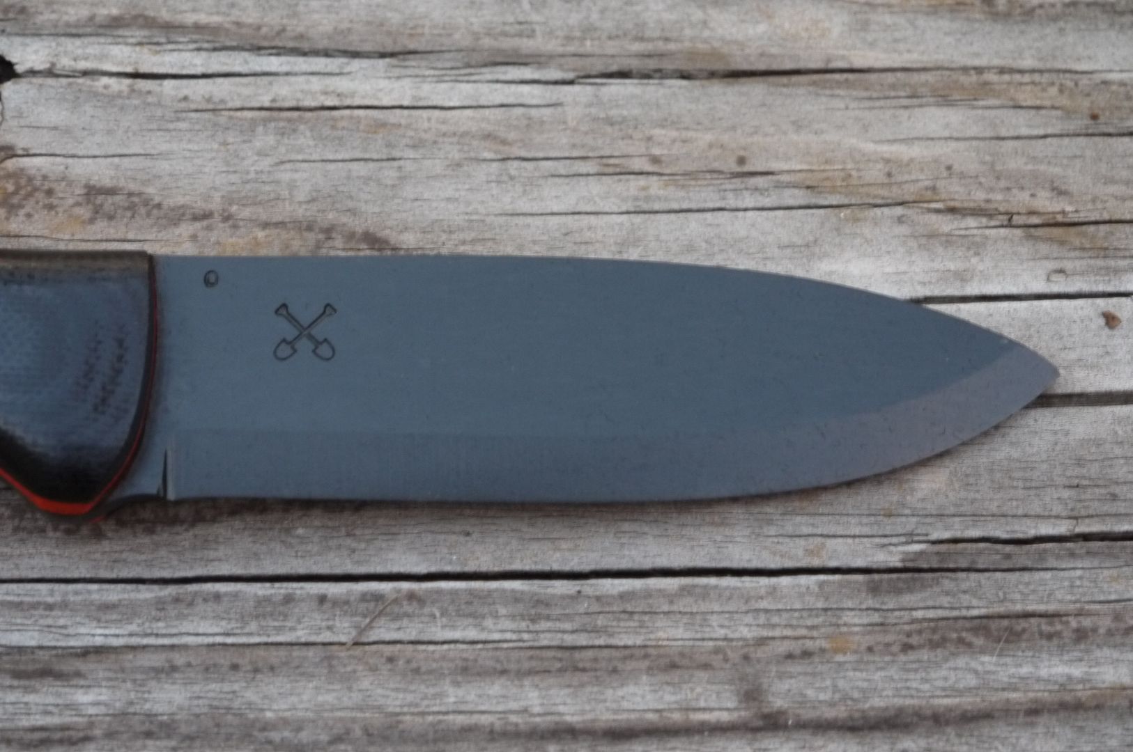

Apple cider vinegar will always patina darker than regular white vinegar. Here's one I did for 1 hour in red apple cider vinegar:
That almost appears like a DLC. My hope was for a gray with subtle blue/purple tones - something that looks aged. People seem to have luck with strawberries, apples, onions and grapefruit.

It's really simple! I used an old flower vase, tall enough to put the whole knife in. Fill it with enough apple cider vinegar to submerge the whole knife.
But before you put the knife in the vinegar, make sure you wash it good with soap and hot water, to remove any residue and oils from the blade surface. Avoid touching any part of the blade after washing.
When the knife is still warm from the hot washing, gently submerge it tip-first into the vase. An hour will usually do the trick.
After an hour has elapsed, pull the knife out, and immediately rinse it with cold water to lock the patina in. Take a napkin, towel or rag and dab it dry. Don't wipe, as it may wipe some of the patina away.
Once the knife is dry, dab some oil on the blade and then you're done!
