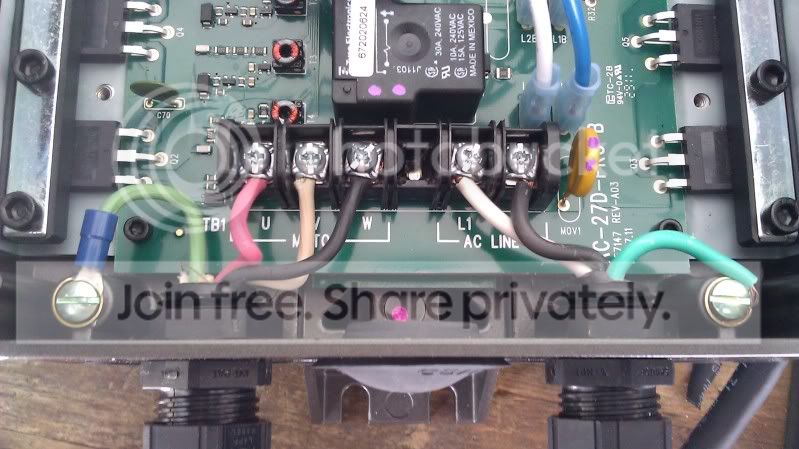

I'm assembling my KMG and had a question on the wiring. The green grounding wire on the left side goes to the motor and KMG provided this forked piece that goes under the screw. Am I just supposed to stick the metal from the green wire into the blue part of that piece as pictured below? I'm used to grounding wires that wrap around the screws like I did on the right so I just wanted to verify with you guys before turning this thing on. Thanks for your help!
Crimper is my answer! My Engineer neighbor saw me working on the garage and gave me the answer I needed. Have a nice day!
Yes, crimping is the answer,
I also like to cut the blue plastic off and solder the crimp.
That way the connection stays clean and wont corrode years later.
