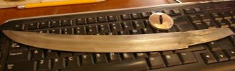

Hi Guys,
I found a decent picture of the type of blade i was looking for. It's a tanto, blade approx. 15", made by John Smith.
Dave

One of my favorite shapes:

To really get the effect, make it come to a fine point, like a fillet knife. The kissaki should go all the way to the center of the blade.
One reason this is an uncommon blade type is the difficulty in the togi.
An alternate style is having the blade taper from the saki to the yokote, and then reverse taper a bit back toward the machi.

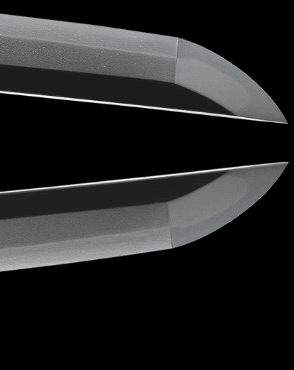

That's some good stuff. I also appreciate the advice. One question, in the picture I've attached, it looks like a layered grind, for lack of a better term. Do you know what it is, and can you clarify?
Dave

I think you are refering to the Yokote(ridge line) that separates the Kissaki(tip) from the rest of the blade. It signifies where the upsweep of the tip begins. Some makers do not accentuate this. I haven't really dabbled in japanese blades much but pick up things here and there when hanging out around Wally Hayes' shop.

Yes that is what you are seeing.
On most blade polishes, the kisaki ( tip) meets the ha (edge) at the yokote (junction line) about 1" from the saki (point). This isn't too hard to polish as a crisp line. On an osaraku blade, the junction is such a small angle change that it takes a skilled togishi ( polisher) to get it right. As rick said, many just polish the whole edge as one continuous surface. This is not a bad look, although not truly osaraku. Many who like the look, and want an easier project, make a blade that looks like a fillet blade with a nakago ( sword tang). The sides are usually hira-zukuri ( full flat or full convex grind).

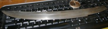

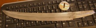

By the way, if the terminology ever confuses you, there's a lot of documentation out there. I like this little diagram someone came up with (don't know whom to credit for it):

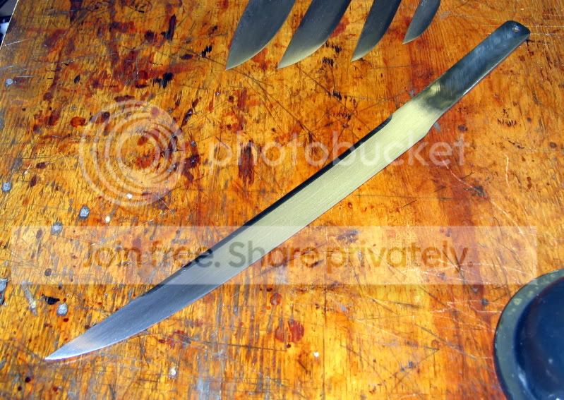

Inspired by this thread and ready for HT. As you can tell I am not attempting the traditional Yokote line... and the Kissaki isn't as dramatically drawn out as some in this thread. It's my humble interpretation.

A tip for a more dramatic look in osaraku-zukuri is to draw a low arc on a piece of paper - about 1/2" height in 20" cord is enough. Use that as a check on the spine when curving the blade in forging/grinding. You want as even a curve as possible, not just a rise in the tip. This looks a more "Japanese" look. Also, make sure the tang follows the same curve. The edge of the knife should be a smooth curve too, getting wider toward the middle of the blade then tapering a bit toward the tang.

I am not doing the traditional Tsuka mount either. I will do my leather backed hemp wrap. Here is a scale reference shot...
