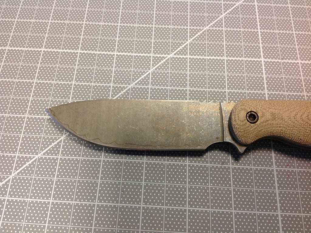

I didn't strip/patina this one but bought it off the exchange from someone that way... But the patina job wasn't the best and when I was replacing the hardware with stainless I found some rust under the scales. Ended up doing a red wine vinegar soak and darkened it a bit, then liberally applied mineral oil and some chapstick along the edge of the exposed tang on the handle.
I did however strip this KA-BAR Famine using CitriStrip which gave it an awesome patina in the process:
I detailed the process here.
CitriStrip is my preference because it's way less toxic than brake cleaner or other solvent heavy VOC strippers. You can use it indoors, which is nice.
Totally worth it...!
That BK16 looks really nice. I think those are the scales I just ordered and they look great.
I wouldn't mind a natural patina like the CitriStrip left on your Ka-Bar. Do you think it protects as well as any other acidic patina? Also, how long did you leave the citri-strip on before you started scraping it?
Citrustrip is great. We use it in the workshop. Never really timed it. Just slathered it on and go do other things.
Generally, the deeper/darker the patina, the better the protection. The patina is a form of corrosion/oxidation, essentially 'pre-rusted'. But you will still need to perform some care maintenance.
I left the CitriStrip on for about 45 minutes out in the sun to warm it (not sure if that helps but figured why not?).
I used a plastic paint scraper because I was paranoid about scratching the blade. Don't be fooled about CitriStrip not being powerful just because it's "natural"... I had on a pair of latex gloves and after handling the coated blade and using the scraper the CitriStrip ate through them! Also ruined the plastic scraper as well. You can tell the stripper is working when the epoxy coating is literally "bubbling" up and it seems the thicker you apply it, the quicker it works.
No matter what though, you still want to use a little oil on the blade like Travis mentions. I use mineral oil because it's cheap and won't poison me if I cut food with it on my blade. It's preventative maintenance just like honing the edge after using it.
