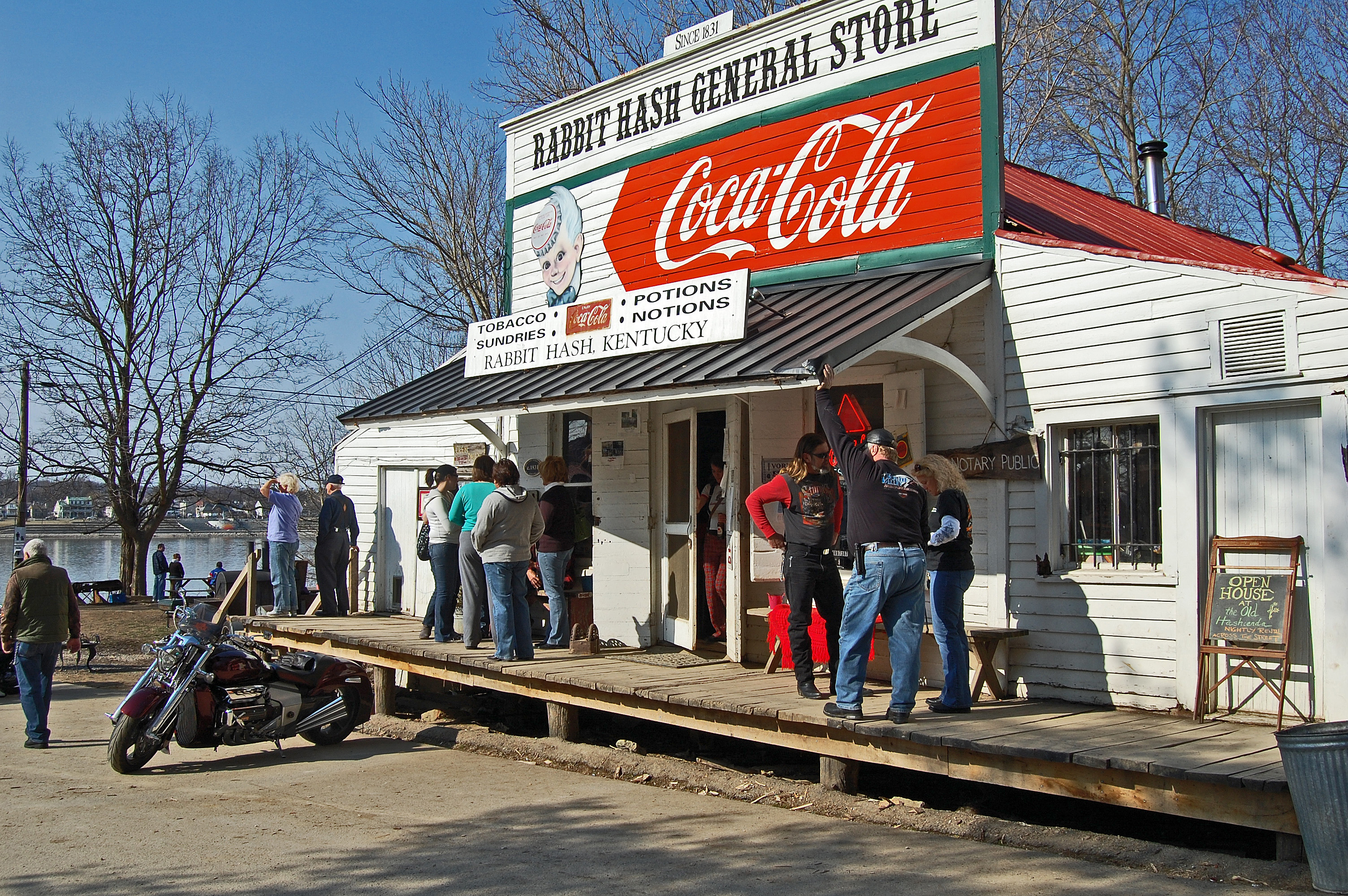

rwc53 - I work in Kentucky fairly near Rabbit Hash. I've never been there but have heard and read a lot about it. It's a popular place for motorcycle riders these days as it's a nice wooded ride to and from. They elected a local dog mayor for a few terms.
http://mpgarr59.wordpress.com/2012/12/21/a-little-slice-of-heaven-rabbit-hash-kentucky/

davek, thanks for the photo of the Rabbit Hash General Store! That sure brings back memories from my youth (late 50's, early 60's). If I remember correctly, where the bikers are standing on the porch, there used to be an old-fashioned drink cooler full of ice water, with ice cold sodas inside. Of course, these memories are over 50 years old, so I could be wrong!
