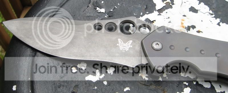

I will keep you guys posted on this....I am in the same boat. I am not a big fan of the DLC coating on the blade or the frame (or at least I was a fan until it started to get scratched up). So I sent it off to get bead blasted. We shall see how it goes - Ive got my fingers crossed. There is a member here (dslteck) that offers free bead blasting and stonewashing to forum members, so I am taking him up on his offer. The package is en route to him now.
Here is a DLC coated blade he did for me.
Benchmade never offered DLC for the Skirmish. The only coating option they had was BK1, which isn't the same thing.
Good to see that the logo's still sharp after that treatment though.

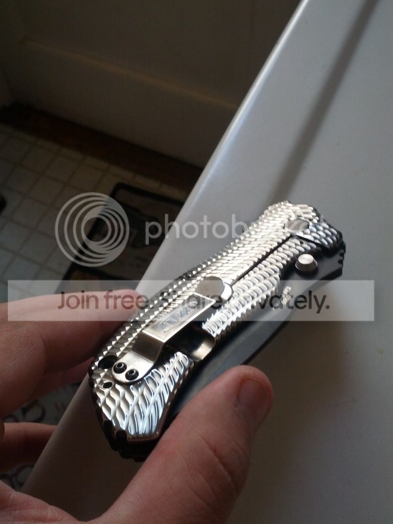

I put forth a pretty serious effort to get the coating off of mine. Had I known how much of a pain in the ass it would be to get the grooves completely... I would have never started. This is after a few hours with a dremel, 000g steel wool, and an hour with a tube of flitz. I actually did this with the intention of flaming my titanium lock side as well but noticed there is STILL a small amount of paint in the grooves.

I bought a dremel 4000 and just used the all three of these finishing wheels start to finish removing the black coat (http://www.dremel.com/en-us/Accesso...x?catid=2042&catname=Finishing+Abrasive+Buffs). I also gave this a shot but didnt like the way it was affecting the material. I read someone used 000g steel wool and gave that a shot for about 30 minutes but didnt really notice too much of a difference. I tried everything on the back side of the scale to see how it would affect the knife. I finished the knife with these three and a tube of flitz paste.
http://www.dremel.com/en-us/Accessories/Pages/ProductDetail.aspx?pid=414
http://www.dremel.com/en-us/Accessories/Pages/ProductDetail.aspx?pid=429
http://www.dremel.com/en-us/Accessories/Pages/ProductDetail.aspx?pid=423E
If you have any experience with a dremil or polishing you will probably have better results than I did. It was my first try at polishing and my first dremel.
