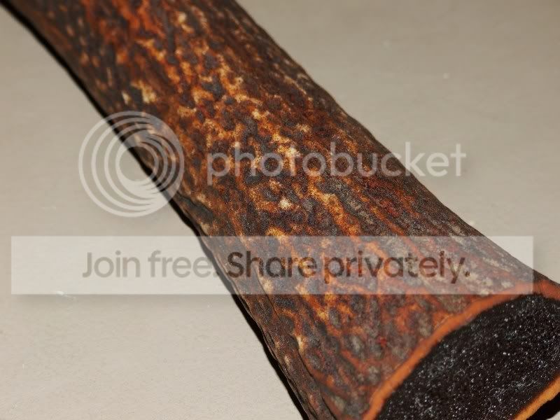

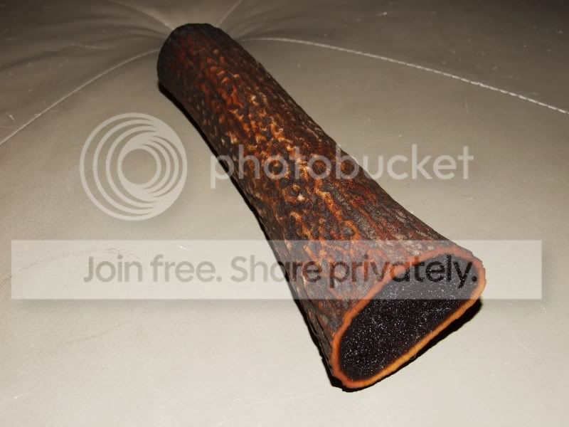

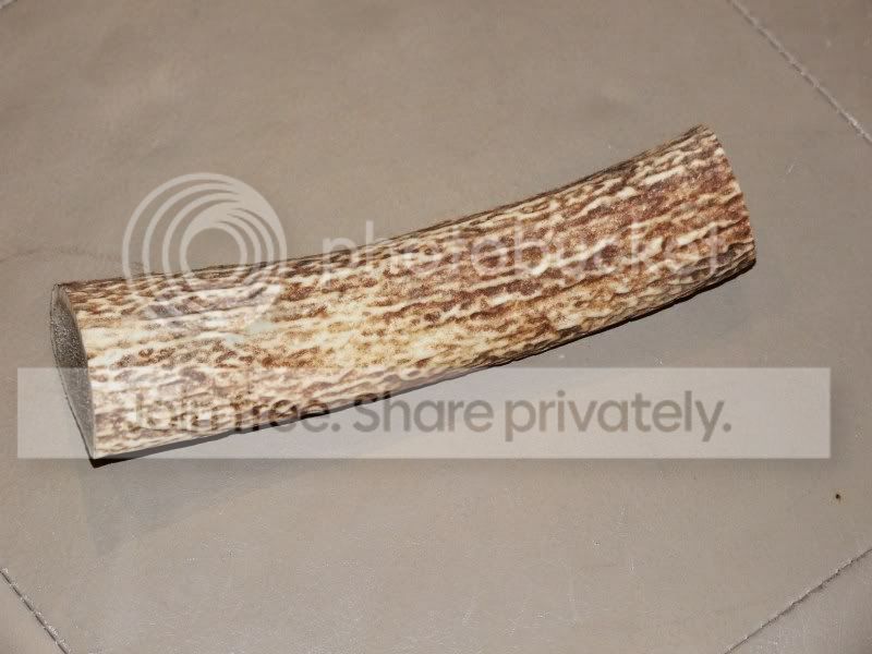

Thanks for the input guys! I have had the piece of antler in dying for 3 hours now in a PP mix of about half a teaspoon and the part lowest in the mix is already a black colour with the base a darkish brown...will likely take it out in a few hours time to dry, not sure if I need to cut this piece of antler down but if i do I'll be able to photograph how deep it penetrates.
I have taken a before shot and will take an after shot as well to show a PP treatment.

I had it in 5 hours in a diluted mix as recommended by a local smith whom supplied this piece of antler to me (also a member of this forum)...I have used antler previously but left it as nature handed it to me, but considering this piece was already pretty bland in colour I think its come out great for a camp knife intended for use.
There is distinct contrast already after it being out for 1 hour and a scrub with a green scouring pad has revealed white on the higher parts of the texture. The part deepest in the mixture is a dark brown/almost black but I like how the colour varies so much down the piece of antler.

BEFORE:

Funny thing about people saying the dyes will go deep seems like a false or exaggerated statement from my experience playing around with PP as a dying agent to this piece of antler...where I made the antler almost black with PP, light sanding revealed the white again and it has a very natural/antique look to it, the contrast is similar to a whole antler with natural color I have been saving for the right project.
