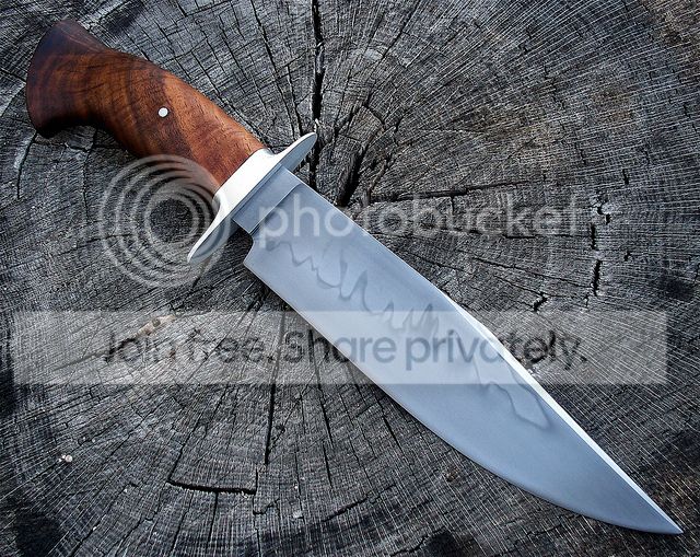

Although I've seen the term used for just about every type of knife, to me a Bowie will always be a big knife with a clip point, like this one of mine made by Matt Lamey (W2 and walnut).
