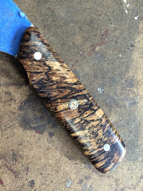

The first two here are end-grain Spalted Pecan:

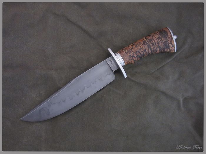

Followed by a set of four I did from end-grain spalted maple:
And I had no fear whatsoever doing one with scales on a frame handle:
