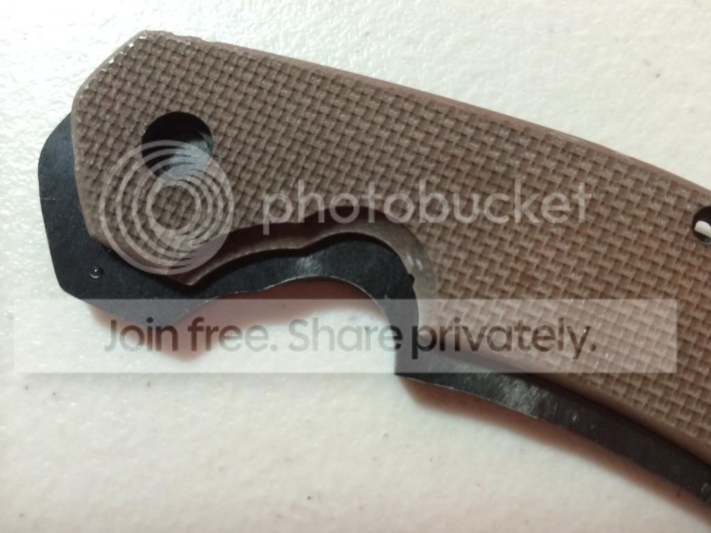

The materials came in and I didn't know that the scales were shipped in sets of two, this surprised me and caused me to first work on carbon fiber because I had 2 scales so I just blinded myself with a stupid reason and got to work.
Well after 2.5 hours of work this is where I'm at.
I didn't take pictures of the steps because working with carbon fiber and taking pictures probably don't go together well and I'm glad I didn't.
I clamped the original scale to the carbon fiber plate and than cut off with a Dremel Diamond Wheel portions that could be cutoff easily. Than I proceeded to use the Dremel sanding drum and sand til there was a bit of excess material between the original scale and the carbon fiber. I than tried to file it down but the file I had wasn't coarse enough and took out very little material. So than I proceeded to use the sanding drum again and this is where my first errors occurred. When I use the sanding drum I try to keep it flush but I sort of try and not damage the G10 scale. This would cause it to be slightly off angle so my custom scale's edges aren't perfectly flat, they are slightly angled towards the right. It's a very small distance but what it means is the right side of the scale is a tiny bit smaller than the left side and when I test fitted it to the original knife it doesn't match perfectly flush. I sanded it with a file and than with 220 grit sandpaper.
The biggest error I made was when I was using the edge of the file I accidentally ripped into the G10 scale on the thumb rest area (the edge of the file is much much faster at moving material than the sides unfortunately and it is easier to apply more force on an edge). This caused a tiny nick and so I had to use the sanding drum to drill out the tiny chip in the carbon fiber. So my thumb rest is now slightly larger and will show a bit of the titanium frame beneath.
Overall, I can't say I'm terribly disappointed. I expected a colossal failure but I think I have a scale good enough to be used at least. But tomorrow is the tough part, I have to drill the holes into the scales. My plan is to clamp them onto the workstation I have for the Proxxon rotary tool and than alight the drill bit. Than I will drill through. But we shall see. But enough with the chatter, here are some pictures!
At least they look similar!
The tiny chip I was talking about on the G10 which forced me to make the thumb rest even larger for the carbon fiber scale.
I just realized that I have to also thin out the scale. I need to trim about 1/32 inch off. I'm assuming 220 grit sandpaper sanding it flat would take too long. Would 100 grit or even 60 grit be better? Also I just realized I could shave the angled side off and it would bring back the balance (though probably not all of it). And for those wondering where are the carbon fiber patterns, this piece of carbon fiber happens to be marbled carbon fiber so I have to sand it to get the pattern to show. Thanks in advance.
