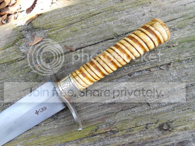

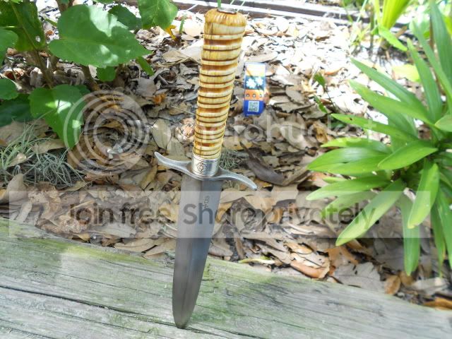

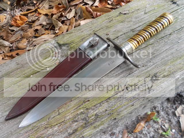

The best and old way is to fit a wood plug in the bone, along with cutlers rezin. Today we can use epoxy in lew of cutlers rezin. Then you can drill through and treat it most like any other through tang grip. Elk leg bone works well. Deer for smaller knives. This dagger was made as a through tang riveted over a washer on a bone butt cap, and was inspired by an original in George Newmann's book, "SWORDS and BLADES the AMERICAN REVOLUTION"

Thanks, LRB for the picture. Beautiful knife.

LRB, I have admired your work for some time and that dagger is no exception. Very nice. Is there any risk of a wood plug expanding inside the bone due to moisture and causing the bone to split? Is there anything that should be done to prevent this?

I would think that as long as the wood is coated with epoxy, and also the ends, there would no effect from moisture. I seal all joints with epoxy, even blade to guard. I have found no great difference in bone from animal to animal, in general, but I'm sure there may be exceptions. Stabilizing would be a good idea, but in the work I do it might cause more problems than prevent. Cooking/baking can do no good to bone. Heat and a constant dry atmosphere can cause cracking and a break down of the surface making it chalky. Air conditioning is detrimental to many grip materials, if exposed for long durations. I even had Westinghouse Micarta shrink from being in AC for 3 months or so. Most of the whole bone I get is deer, and has been buried for a couple of months, and or, just left exposed to the elements. When I use slabs, I buy them. Probably water buffalo, or cow. I very rarely have problems of any kind with these. I have a friend who has used the leg bones from some large bird in Australia that are very impressive. These are nearly true round and quite straight. I will see him in August and try to find out how he gets them.
