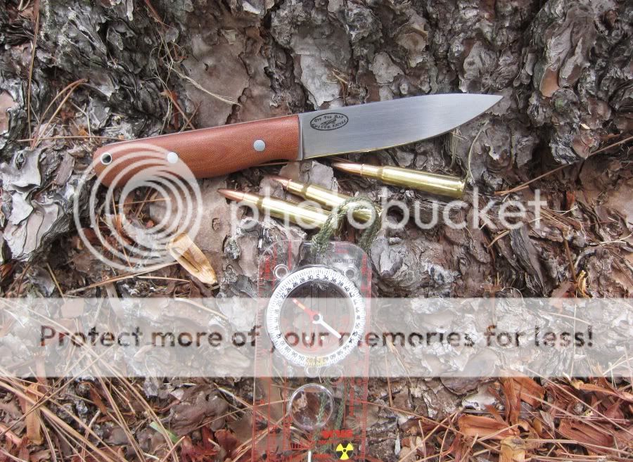

I was wondering if you guys could clear something up for me. Is there an accepted definition for a "bushcraft" knife? Is it a full-tang, scandi-ground knife with a spear point blade? Or is it like the bowie (i.e., a type of knife that is not easily defined).
The reason why I'm asking is because I was recently gifted with one of the Spyderco Bushcraft seconds. I have been curious about bushcraft knives and I want to know if this knife is representative of the type. Are they always this stoutly built?
Here are the shots of my new knife since I think threads are better with pictures.
Thanks for the help.

you did score a sweet looking knife tho , I see them spoken higly of a lot , tho I never owned one myself
Don't think one can define "bushcraft knife" exactly although the Spyderco knife that you show is a typical example. The person Myal is referring to is Ray Mears and he has a bushcraft knife of his own design which sells for an astronomical sum of money.
From my observation the blades are usually around 4", lack any substantial finger guard and try to be an all-round basic woods-use knife. With that being said, you may be opening up a can of worms here because the term "bushcraft knife" is so ambiguous and controversial.
By the way, your Spyderco example is very nice and was discontinued by Spyderco because of flaws in the scales and were nicely discounted because of it. Wish I had gotten one when they first came out. They now come with a G-10 handle (which I do have.)

You should've seen this knife before I cleaned it up. The scales were shrunken and cracked and I scratched the blade up a fair amount during sharpening. I recognized its potential though and because it was a gift I went to work. I filled the cracks with some CA and applied some Tru-Oil to the scales. A little bit of elbow grease smoothed everything out. I cold blued the blade to improve its appearance. She looks pretty good now (good thing too as I can't stand an ugly knife).

That's a nice knife you have there and now you've put the work in, it should serve you well. It a shame there were stabilization issues with the spalted slabs and you seem to have got lucky with the cracking around the lanyard hole which was the most common problem. That's the trouble with natural materials, they do move. But the feel (to me) is worth the extra care requirements.

That Spyderco looks like a great blade which has all those charateristics, but only you as the owner know for sure if it is right for you, hope it serves you well.

And yes that knife is what most people would call a "bushcraft" knife.

I don't know if I "fixed" it, but I resolved the issue to my satisfaction. I filled in the cracks and gaps with CA and sanded them down flush with the scales. The good thing about the Tru-Oil treatment is that it gave the CA a brownish color, so the repairs almost look natural at first glance. The tang is still proud of the scales, but I radiused the corners so that they are no longer bothersome. I guess that I could've gone all out and replaced the wood, but the knife as a whole is still sound and I didn't see the point in all that extra work.

Kudos to whomever gifted that knife to you! Well done on the TLC you gave the knife to help it last longer and be more functional. I think your knife would easily be considered a bushcraft knife. With continued care, I'm certain you will have a friend for life in that knife. I also hope that you sent the gift giver a silver or gold coin in return. :)
