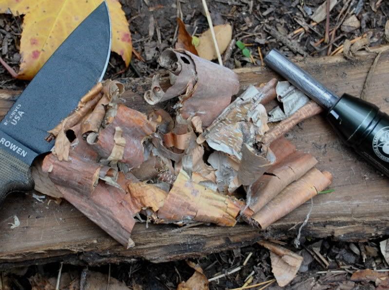

If you want to do it the hard way and not use the cotton balls, there are a lot of things that make good tender. Just make sure it's dry. Birch bark, cedar bark, cattail heads, rat and bird nests, etc. I like the seed pods at the top of many weeds in the fall and winter as well. Your best bet is to get out in your local area and try different tender to see what the fastest is in your neck of the woods.

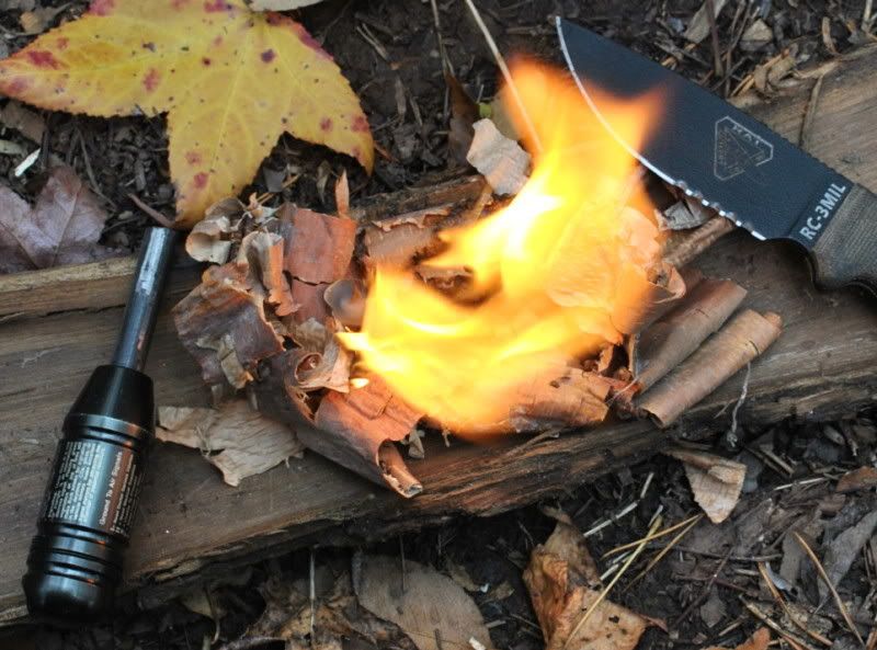

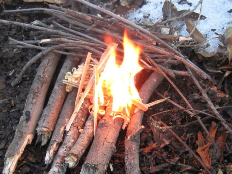

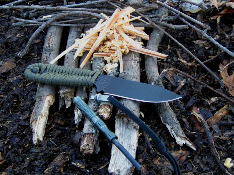

Cedar bark, thin Fatwood shavings, Any feathery seeds or old mans beard mixed with Balsam sap or pine resin. Try carving some wood into a pencil sized shape and then use a pencil sharpener to make really fine shavings !!!

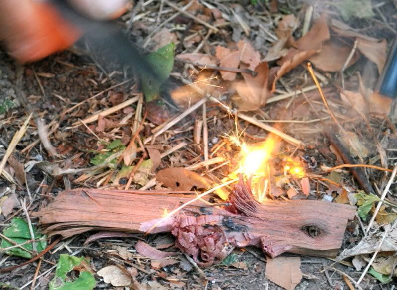

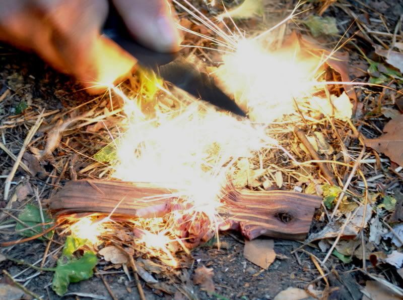

try pinning your tinder to the ground with the fire steel and allowing the sparks to be directed directly into the tinder
FIne knife shavings of dry wood, and fine strips of teaased birch bark are easy to ignite this way
also when selecting tinder the about the 3 F's fine, fibrous, fluffy something that is all of the above is ideal like fluffed up cedar bark, but something that has any of those qualities in various degrees will work.

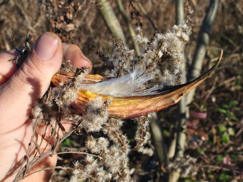

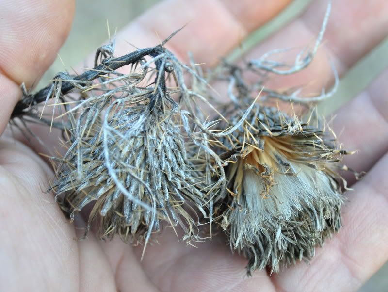

Thistle, grasses, horseweed, and milkweed pods all work pretty well.

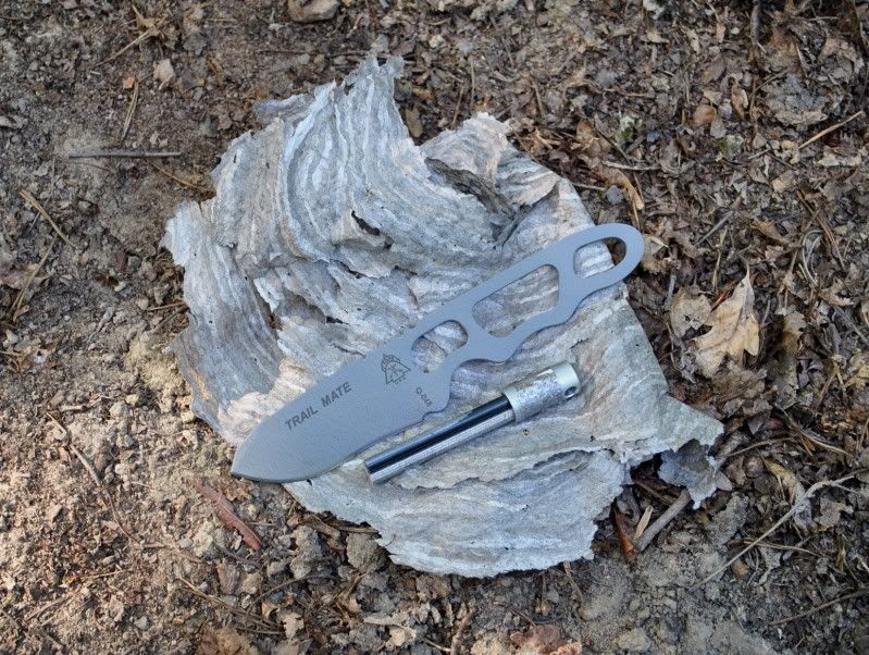

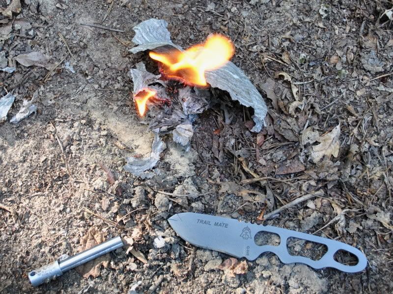

Hornets nests work really well.
Fine dry wood shavings.
This is what I do. I see a lot of guys who hold the knife still and pull the flint backwards. The result is the sparks have to travel a few inches into the tinder. This means some of the sparks go out before they reach the tinder and/or you have sparks missing your tinder entirely. The way RR describes, all of the sparks are shooting straight into the tinder and creates a lot more heat IME. The only caveat is you have to be careful not to disperse your tinder with your striker/knife.
This technique is somewhat dependent on rod size and type as well though. It works great with the LMF type rods that throw sparks easily even with light pressure, and works good with the longer well made mischmetal rods but some mischmetal rods need more speed and longer strikes to get more than just shavings of the rods (which these shavings also add to the tinder pile) and with these rods the risk of scattering the tinder, depending on the type, is greater.

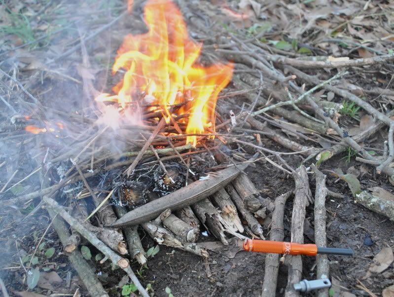

If any of you live where Milkweed grows, collect some of that in late July-August when it starts to go to fluff. Save it for future use. That stuff will catch a spark and go up like a bomb.

I had success with the dryer lint and cedar shavings. Thanks for all the different info on fuels for starters everyone. Unfortunately we have no birch that I know of in my area (North Texas). I will have to try the milkweeds there's usually a good crop of them everywhere each year.
