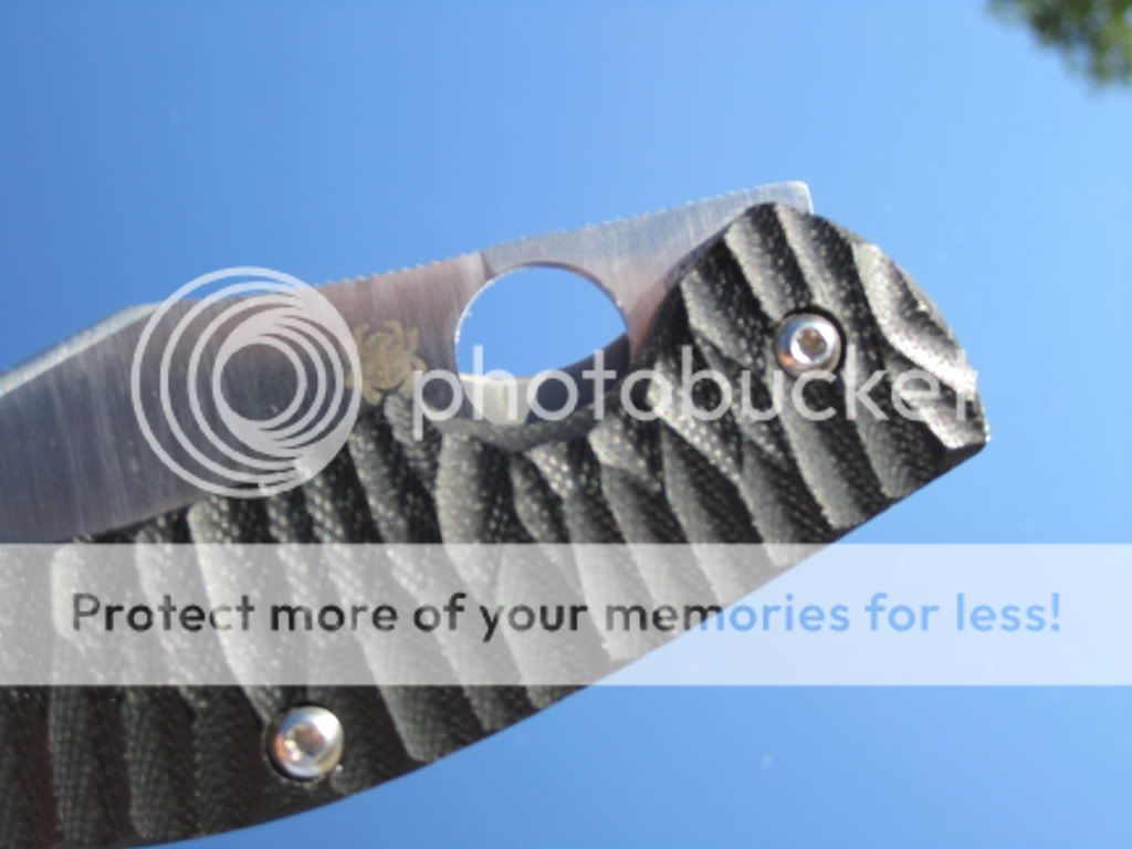

What I don't like, and frankly won't tolerate anymore, is a Spydie hole that is partially obscured by the handle. Imagine having your car door partially obsured by the body, so that you could only grab part of it. On the PPT, the obscured Spydie hole prevents good thumb access, which for me results in a 2-stage opening. First, the blade swings out about an inch, which allows the thumb to completely fill the Spydie hole. Then in stage 2, the thumb is allowed to push the blade open as with any Spydie. This design places looks over function, in my view, though I'm sure that Mr. Sal and company would contend that any additional relief to expose the Spydie hole would also expose the frame lock, thus making it more susceptible to unintentional disengagement.

Partially obscured Spydie hole.
