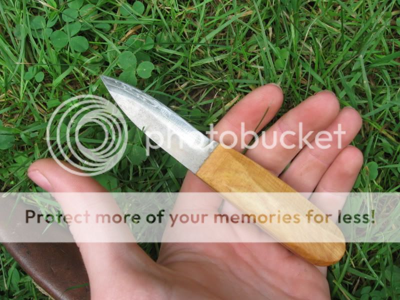

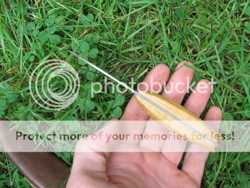

1/16" thick A2 tool steel, Paul Bos heat treated to 60 RcH, saber convex ground. Scrap maple handle scales, metal putty as adhesive.

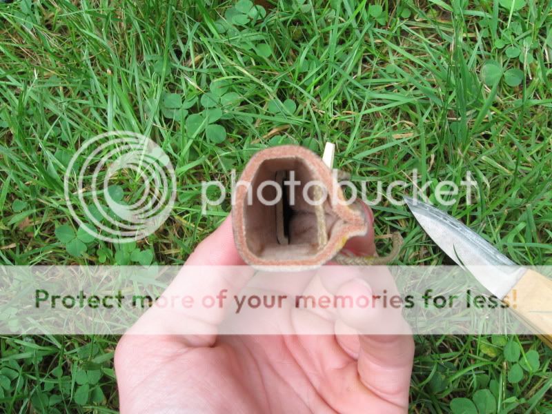

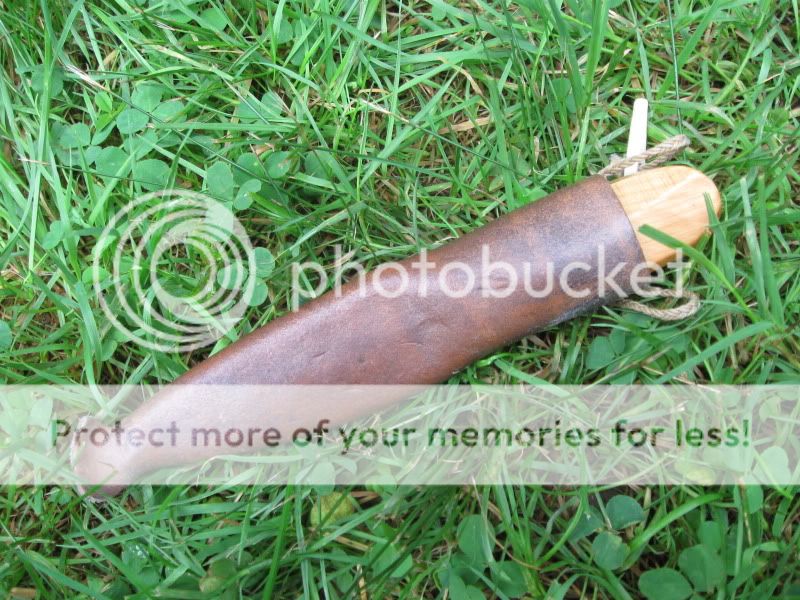

The leather pouch sheath has a wood liner and the dangler loop is easy on and off by using a toggle.
I tossed this knife together real quick for myself, so I didn't make it pretty at all. I also used an experimental adhesive that seems to be working fine for the last month or so.
