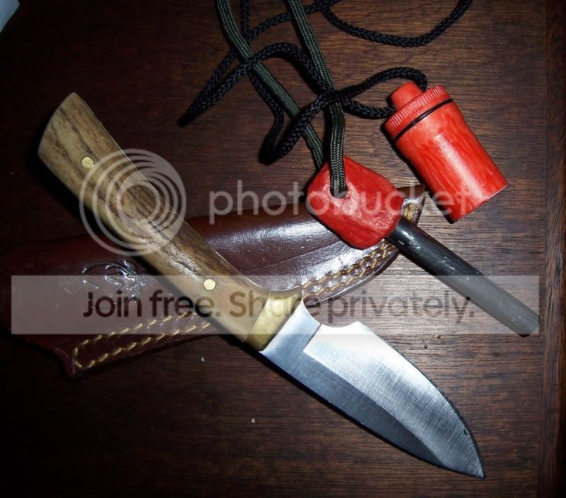

Here is my mod. I bought this a couple years ago and this is the only one I ever owned, I used the hell out of it and about half of the other side is missing. I will be getting my blanks soon and am going to make antler and micarta handles for them. I also want to try mounting one on to a spy capsule for holding tinder, that would be the most usefull handle IMO.
Excellent idea. Nice looking knife, what is it?
Doc
It's a muela (spanish), nothing super but I love stag and its so hard to find a good knife with stag scales thats affordable. This one was $80 I think.

That mod looks much better. What did you paint it with? Also what is that little capsule and what do you keep in it?
I used to carry a film canister with vaseline soaked cotton bottles. Now I just use the piece of fatwood as the tinder. I drilled a hole in the fatwood and looped it through the same paracord as the striker and ferro rod. I still want to do up a couple of fire straws to throw into the PSK (just haven't been to McDonald's for about 1 year).

It is orange sharpie coated with epoxy.:o The capsule is what my earplugs came in, it's waterproof and also got the orange sharpie treatment, it holds tinder (PJ balls). I can't use fatwood as well as I can the PJ balls.
