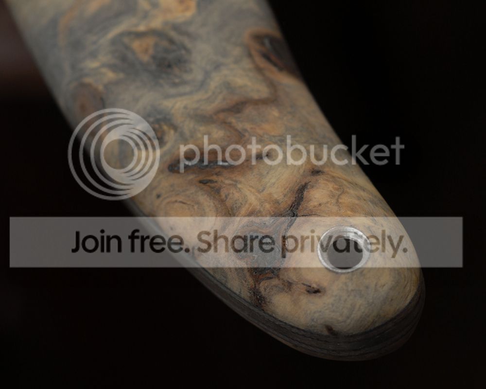

I recently worked with some Carbon Fiber and Silver Twill with some pretty serious voids. I also run into many Natural materials with Cracks that run the full thickness of the scale. These will allow moisture and dirt to make contact with the Tang and eventually cause rust. \
Chuck from Alpha Knife Supply sent me the following directions to fill any voids.
1) Sand the handle to close to finish grit
2) Use compressed air to blow dust from voids
3) Apply small amount of CA to voids
4) Spray with accelerant
5) Wait 1-2 minutes
6) Finish sand and lightly buff
Note: If you get the CA too hot it will go soft and pull out of the voids.

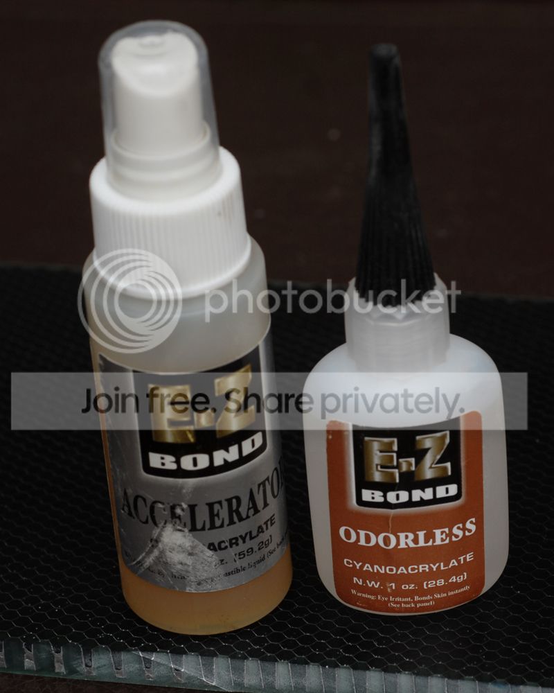

I ordered some of their "Thin Odorless CA" and "Accelerant" and thought I would take a few photos of the process.

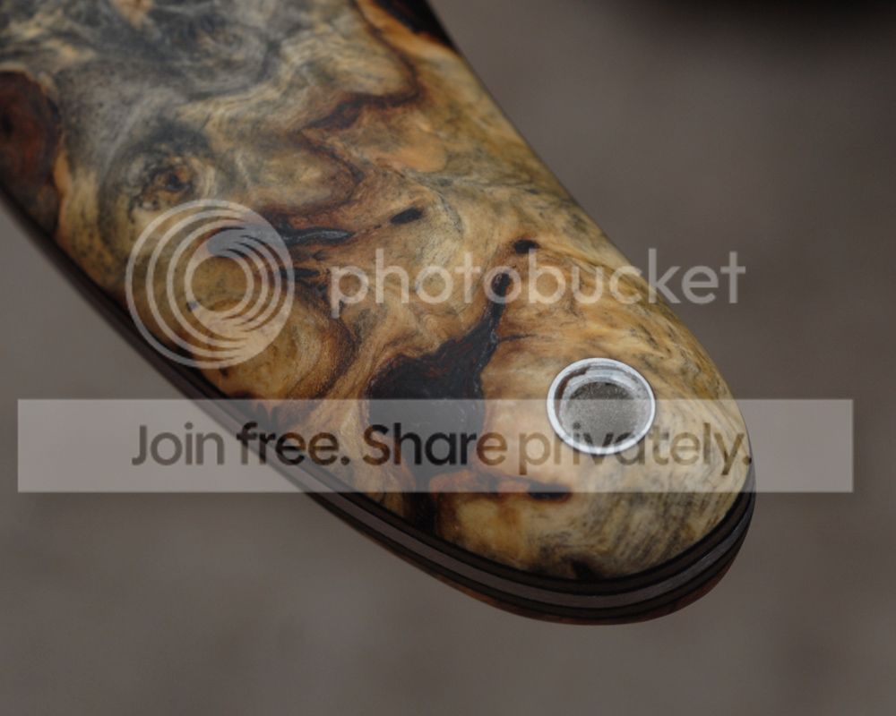

I have a piece of Buckeye Burl (Stabilized) with some pretty serious voids on a knife I am finishing up...

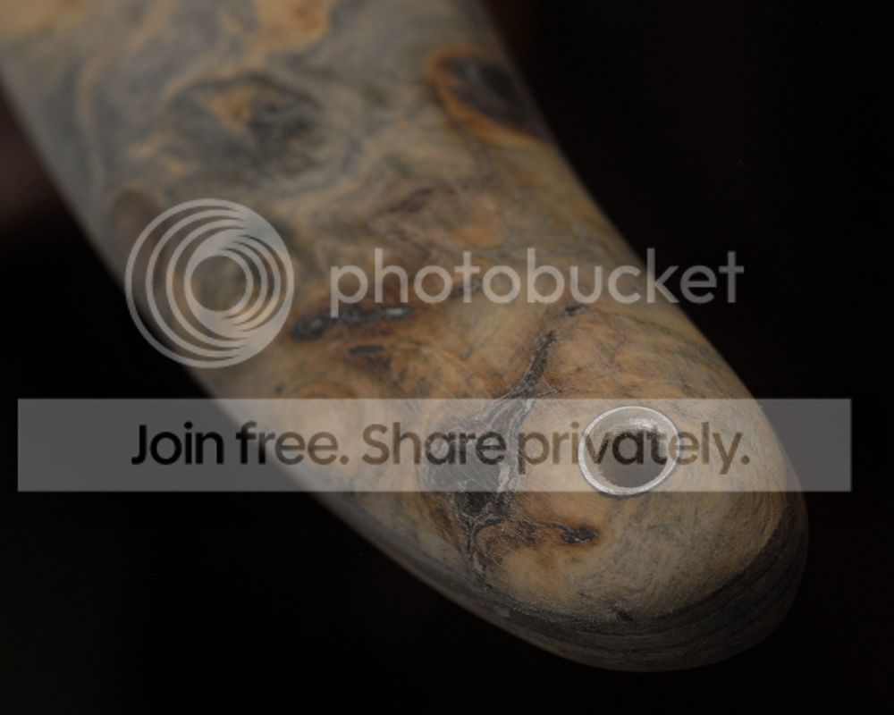

Here you can see what it looked like after I applied a thin coat of CA and sprayed with Accelerant

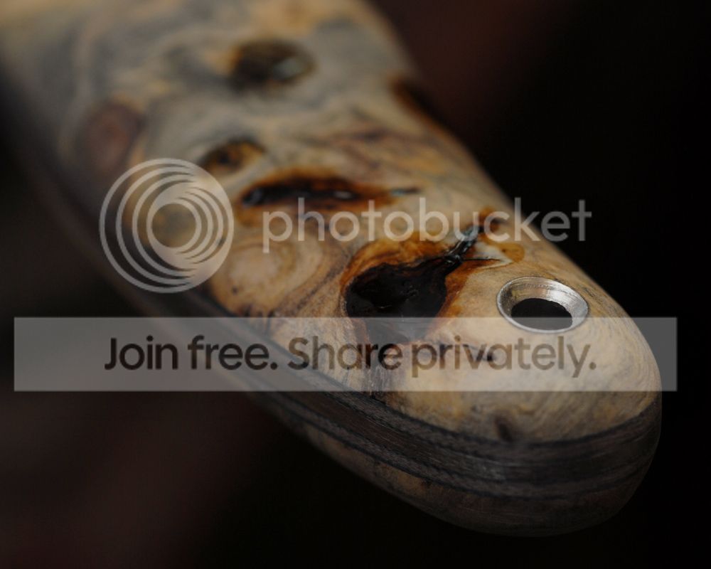

I sanded it down and you can still see some areas that need a second coat of CA

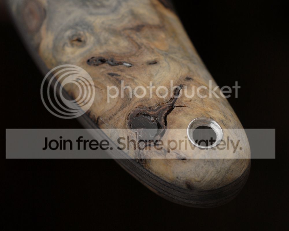

Now you can see it cleaned up with the voids filled
This is what it looked like with the first coat of Tung Oil

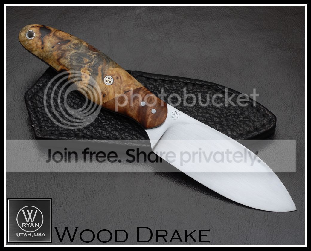

The finished knife...
Thanks Chuck!
Ryan
It does, that is why you need the "Thin CA" this crack went all the way through the scale.
Wow, that really worked well. Not even noticeable in the finished knife. Is the accelerator really needed? Or would a more generic CA glue like Gorilla Super Glue work?

Matt, when you put CA on thick or fill a deep void it actually takes quite a while to cure. I really like using the accelerator because it makes it a quick process. If you search the intranet they say you can use windex or other similar products but it makes the CA turn white.

Great WIP Ryan. I´ve used this procedure myself but with an ultra thin ca called "zap a gap" and no accelerator. Works like a charm.
