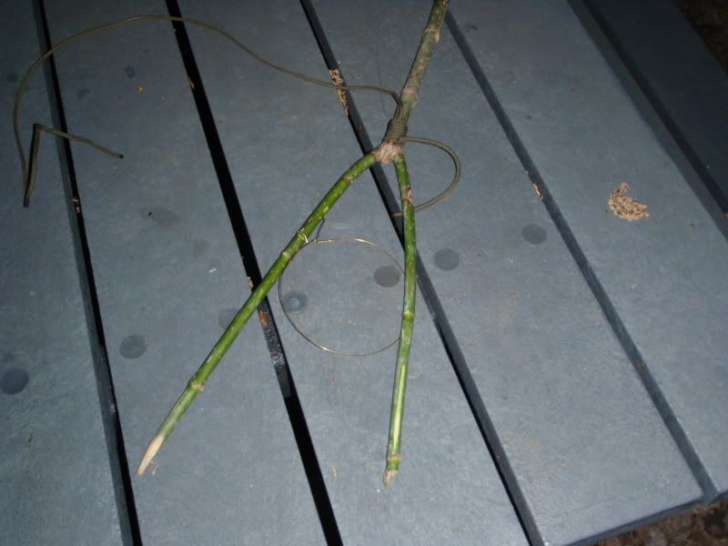

Here is a drawing I made to illustrate how to make and place them...

Yes you could.... Though, I find that this way guides them through the snare loop. I would also be afraid that the upright "V" wouldn't offer the same protection for the snare.... fox, deer, coyotes and other critters would be able to knock it around some... even falling plant matter would be captured in the "V". This way is much more selective, IMO.
