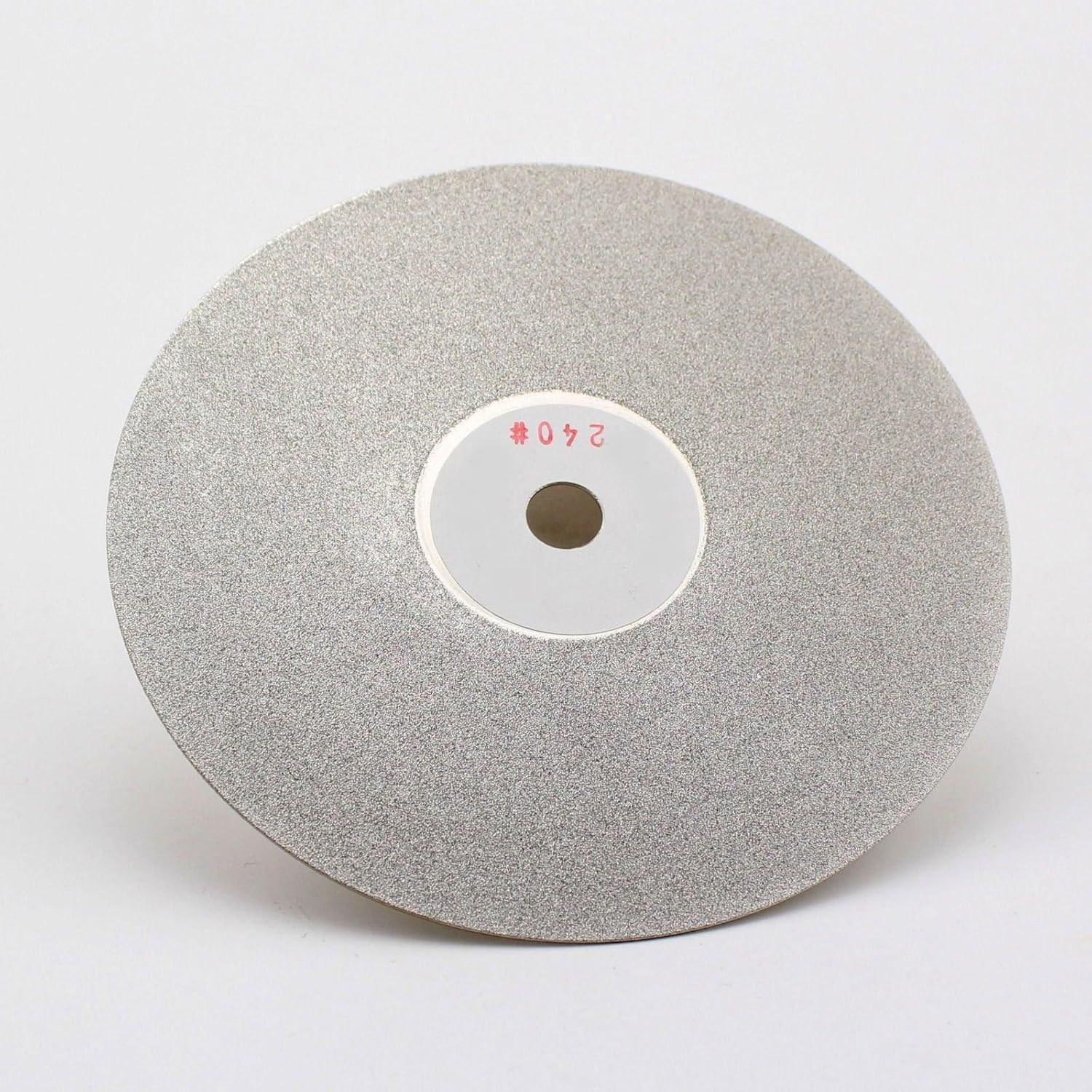

I'm wondering what is the best way to radius a platen. The edges are straight on my ceramic glass platen which I don't love. I don't think I'd want a huge radius just a little softening of the edge. I like a little radius to the plunge line and it's harder for me to get it symmetrical with the straight edge.
I'd appreciate hearing what you all do to get a good consistent rounded edge. And, for those that have radiused their platens, how much?

Would the black SC belts from Supergrit be able to radius a platen? A 60 grit SC belt for $4 doesn't seem like a huge sacrifice. What about those diamond lapidry disks from amazon?
The diamond disc would work. The SC belt really won't from what I tried. A cheap diamond disc would be a quick way to do it.
