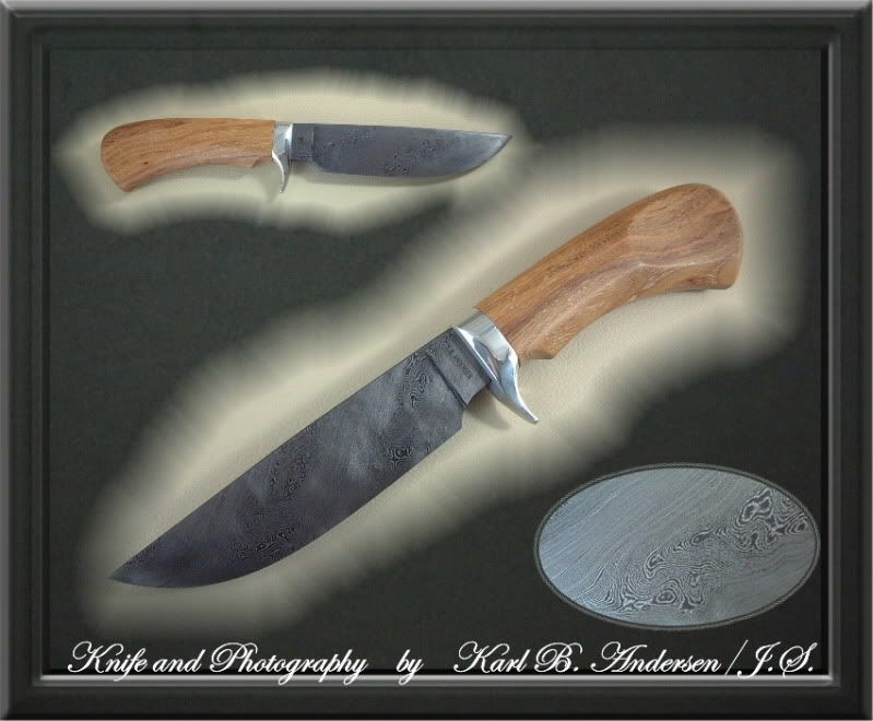

I forged this out of a chunk of "stuff" I found on Jerry's floor.
Just kidding! Believe me - I earned it.
W2 and 203E twist from Jerry Rados' shop.
Now, that handle is the first time I've used some Stabilized Hickory that I sent off a while back. Man! Am I impressed with that stuff!
I've got a buddy across the river who does custom kitchens and such and he had quite a stack of Hickory blocks left over from a job that he was going to use in his wood burner to heat his house.
I cut up some blocks, put them in my shop ceiling for about a year and sent them to K and G for stabilizing.
I am so totally thrilled with it.
It was AMAZINGLY hard and dense and has character and figure that I did NOT know was in there.
Anyway, sorry. I just like it. A lot.
You can sort of see the little "sparkles" in it that I think may be some type of resin or something. It really dances!
And I liked the contrast it gave to the hot-blued Damascus and stainless take-down fittings.
Thanks for letting me run on.
Thats nice. I am confused though. Did you take his damascus and forge it to shape? Or did you take plain steels and create the damascus. I really like the shape, it looks real comfortable.

Correct.
I took a bar of Jerry's Twist Damascus that he makes and forged this blade from it.

You know, Karl, I would really like to start seeing larger/more detailed pictures of your knives. I don't mean to be a nag, but man I feel like I'm missing out on the good stuff, (details).

This better?
