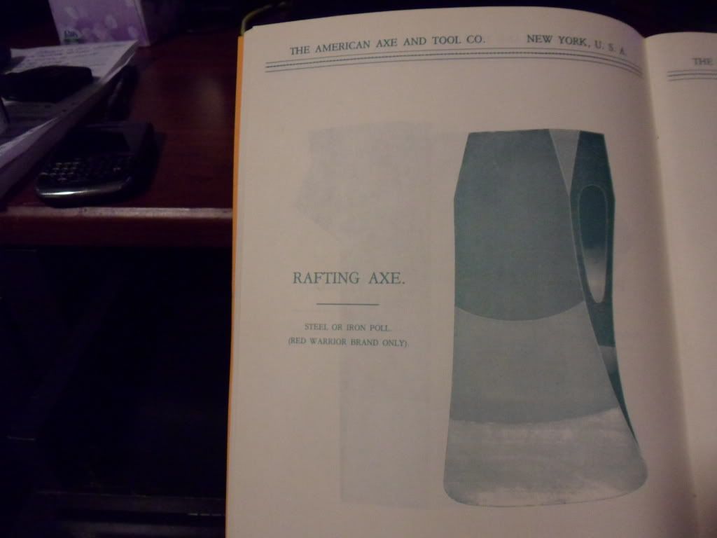

"Rafting Axe"
From 1894 AATco Catalog :
So they have been around awhile, which is cool.
but, this is from the product description on each and every council tool axe, from their website:
The poll and eye walls are not hardened and remain in the as forged condition
why the discrepancy in product description between paper and e-catalogs?
also, if you only intend to drive wedges with a tool, why wouldn't you choose a maul or sledge?
thanks for the info, guys.
-ben

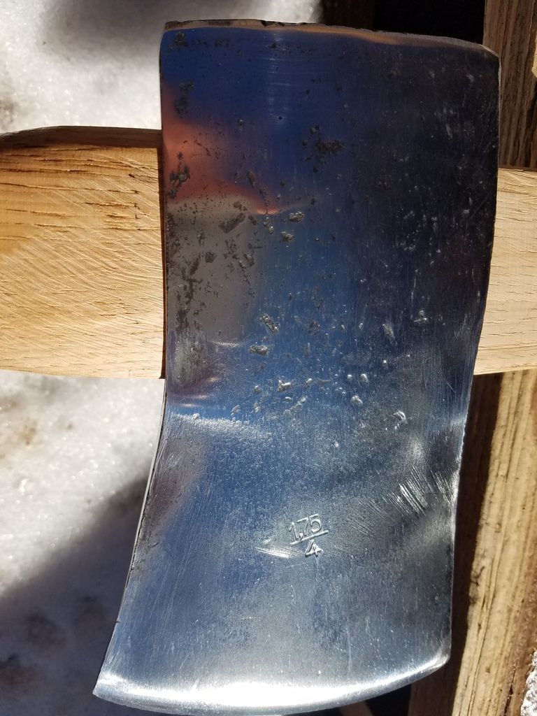

Thanks Steve for this topic. So, my Hults Bruk qualifies as a rafting axe. DM
Doesn't look to be a rafting-style head but neither do numerous vintage American heads that happen to have hardened polls. Best thing for you to do is try running a file over the poll. If it won't readily bite you'll have your answer. You could also try smacking it with a punch or chisel to see if the surface metal dimples at all.
With one of my better files it would mostly skate across the poll. Perhaps one out of every 4 strokes it shaved some off. DM
I would call your HB a hard poll axe but not a 'rafting axe' because it doesn't look like a rafting pattern. I have a hard poll Dayton that I just call a hard poll Dayton. Nice to have but not a 'rafting axe'. But what's in a name?
Rafting pattern axes tend to be short in the poll and long in the bit when measured parallel to the handle. Both bit and poll extend far from the eye so the overall length is likely to be over 8”, with 5 pounders often exceeding 8-1/2”. The poll will also be wider, (+/-) 1-1/2”. This allows for considerably greater steel thickness in the eye. This is a key to rafting axes. Without the thickened eye walls they couldn't withstand use as a maul.
Ok, my Bruk is only 7 3/4" long and 1 1/4" wide at the eye. So, keep it's hammering duty on the light side. Thanks, DM
Right. Good for driving felling wedges but not so much for splitting wedges. I love my hard poll Dayton for driving felling wedges.
I'll continue looking for one with more poll. Which will still work for splitting but I wouldn't care to swing it all day on limb work. DM
