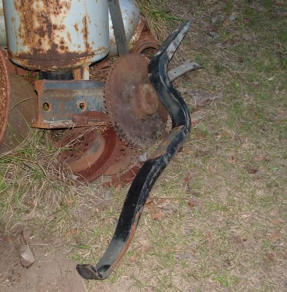

Well Chuck, I guess you've shown us it can be done. I figured as much (cutting it up with a metal cutting band saw that is). I'm in something of a similar pickle with this big rig drop spring which is a 60-70 lb. chunk of 6150! I have enough bar and round stock of good known knife steel that I haven't felt over stimulated to try hacking the thing up . I don't know though, if steel and shipping prices continue to climb...

As far as the metal cutting band saw goes. I have cut up a lot of spring stock on mine. I got 2 cat springs that weigh 200-300 lbs each. One is 2.25 and ons is 2.75dia. It cuts really nice. Just check the material to be cut with a file. If the file cuts use a good blade and have fun.
