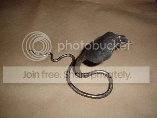

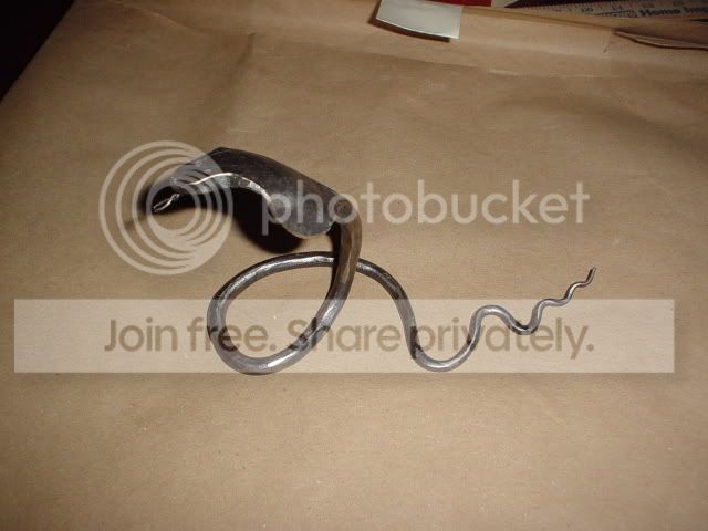

how about one of these!
NOW THATS COOL BUTCH!:thumbup::eek:
