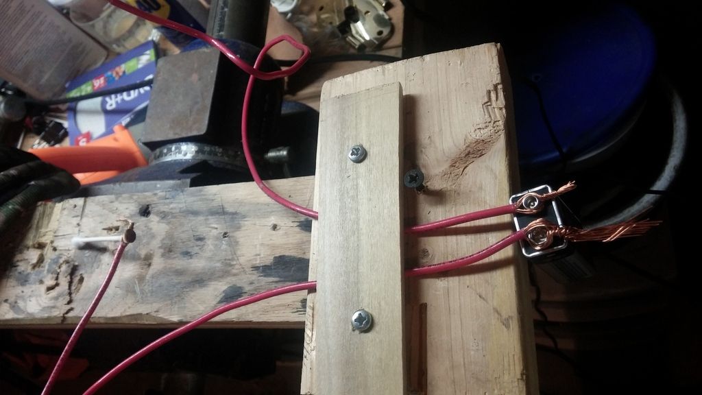

Is your negative lead clamped onto the bare blade edge itself?
If so, did it corrode or scale up the edge in any way?...I'm guessing "No" or you wouldn't do it that way, duh :o....just trying to be certain.

Yup, and when you guys talk about using a 9v cell, you're talking about one of those large lantern batteries, right?
Positive lead clamped to blade
Negative lead clamped to Q-tip
This is how I did it.

Yup, here's a pic of the primitive setup I had. Nothing really to it. Just attached the positive to the edge (I'm not sure if it matters either way) of the blade it didn't cause any damage to the blade. I didn't even think of the potential of it causing a problem beforehand to be honest oops! The only other thing I did was attached a q-tip to the negative end and dip it in salt water. I put about a half a cup of hot water in a cup and just kept adding salt and mixing it up. I really didn't keep track of how much I used. I just made sure when I pressed the q-tip to the logo it had a reaction. You get this really nasty smoke that comes off it so make sure you do it in a ventilated area.
