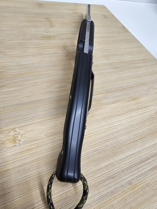

This is my Rajah 2 that I modified removing the thumb plate which I don't need, then just for fun I mirror polished the back of the lockbar and carved the back spacer and the scales so that it gives the illusion of a full tang knife. I also contoured every sharp bit of the handle using a sanding block so now it's so comfortable that you can hack for hours on end with it without a blister :)
At least on this one I can confirm that the back spacer is definitely made up of the same material of the scales and not aluminum or else.
