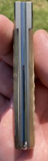

Just a quick question concerning ram’s horn used as scales.
I have been enjoying my 2020 Forum knife immensely. It’s been awesome.
I accidentally left it in my pants pocket and it went through the wash. Now one of the scales is curling pretty bad. The other is just slightly curved.
Is there any way to get them back to flat? Heat gun maybe and clamps? Soak in water?
I could use some input from those in the know.
I would certainly entertain purchasing new scales (any kind really) to get this knife back into service. As of now, it’s pretty uncomfortable to hold.
Thanks in advance.
The up-side is they are screwed on, so you might be able to remove them, get them wet, and re-clamp flat with heat?

I have seen a boyer take rams horn and work it to the shape they needed, so I think it can be moved.
Try soaking them overnight in food grade mineral oil. Recommended for all natural scales, including stag.
just drop the knife in a mug/cup full of mineral oil so its totally immersed

that recommendation comes from Jerry Fisk and other Mastersmiths. I’ve been doing it for years with no adverse effects. You have nothing to lose trying it, as the mineral oil is safe for the blade & pivot. If it doesn’t work, you have thr option to replace the scales. Several members here offer that service
Steam is what is traditionally used for horn bending, straightening, and impressioning. I've seen it done, and done it myself by positioning the scales above boiling water, and then slowly clamping it up between a pair of wood boards and c - clamps. Sometimes it works well, sometimes the results are just mediocre.

Vinegar and Ammonia soaking and straightening are another type of method, but I'd be worried about the smell being trapped.

I think that softening them is exactly what you want to do in order to try getting them back to shape.
The scales have curled up. At this point, you may have nothing to lose by trying mineral oil.
Instead of a soak, maybe apply heavily with a brush and immediately put into wood blocks to press flat. Take it slowly and repeat with oil & pressing. When flat, leave in press long enough for scales to dry completely so they won't recurl after you reinstall.

we are on the same page. I know mineral oil won't hurt the scales....but I'm not sure if it will help flatten them. The mineral oil is supposed to soak through the material (unlike waxes, which just penetrate the surface) and help with shrinking scales - i.e. - restore the inner viscosity which allows stag/horn to regain it's initial volume (shape). I do not know if it will allow them to be flattened, but it can't hurt the horn material to try.

I have not done anything yet. I will start with a hair dryer first to see if heat makes them pliable.
