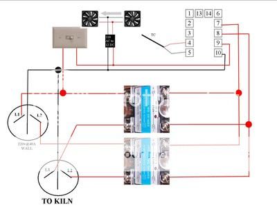

Here is the schematic Jason drew up which includes two fans that he wired in and sent me, Thanks bro! This is for the Auber SLY-2352P If you have a different PID the back of the inputs will probably not be the same but similar so be sure you hook up your PID according to the manufacturer specs.

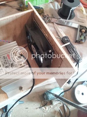

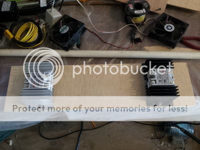

I stared by ripping a piece of plywood 5 1/8 wide and 20"s long which is 1/16 wider on each side of the heatsinks. Use the heatsink paste on the bottom of the SSR's and glue them to the heatsink. Then just screw them down.

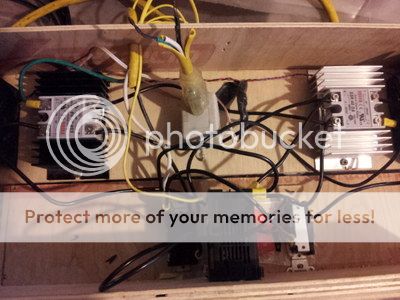

I began wiring up the inputs and outputs according to the schematic Jason made. If you are wondering why all the wire is the same color its because 1 I am colorblind and 2 its cheaper than buying another roll To cut down on splicing all the wires I cut them long and ran them in series using 12g wire through out with connectors. Just trace out each line and double check your work when done. In the pic below I went ahead and wired in an on/off switch that will prevent any power to the coils or the fans till I am ready for it.

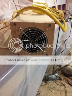

The fans I believe came from a dead computer and are DC so they need an AC to DC converter. You can buy AC fans like these that run on 110v and skip the converter all together but free is better! When you install the fans you want to make certain they are blowing in the same direction so they can draft the heat from the heatsinks out of the enclosure and keep things running cool. The grate is over the intake and I used a hole saw to cut out the opening. Once happy with the fit I pop rivet the fans in place. I wired in the pig tail for the fans to the 110v switch and ground. After that I checked the wiring and schematic twice more.

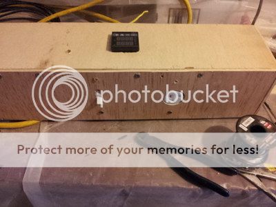

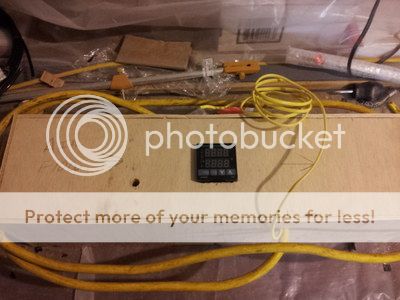

All that is left is to add the power cord and the thermocouple wire. I opted to use the thermocouple that came with the oven instead of drilling an second hole for another thermocouple as I dont want to mess the new oven up but later I may run another redundant probe. Make certain the cable you chose can handle the voltage you will be using. 10g cable is what I had on a broken extension cord so its what I used. Once everything is wired in check the wiring again then close up the box. After I test the controller I will added some metal trim and face plates but till we know it works we will hold off.
All that is left is to add the correct plug onto the power cable and plug it all in for a test run which will wait till tomorrow. I will also add a 110v outlet so I can use the contorller to run my toaster oven too. I will add the type K probe to the toaster oven and plug the oven in to the 110v outlet and we are good to go!
