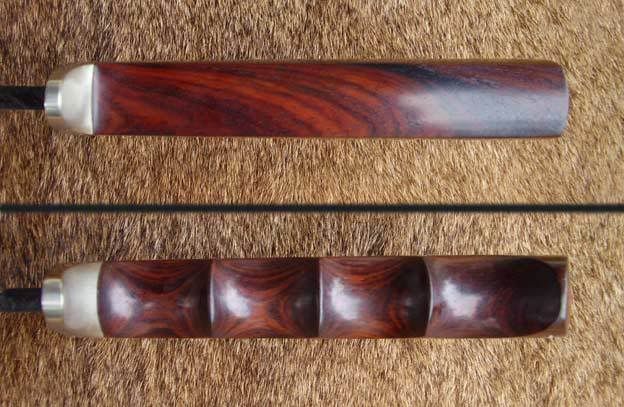

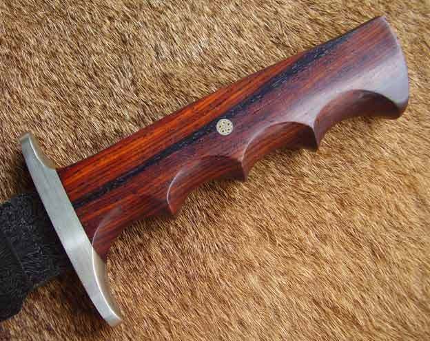

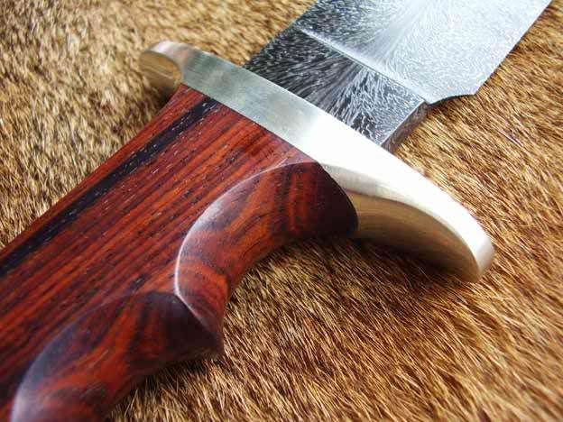

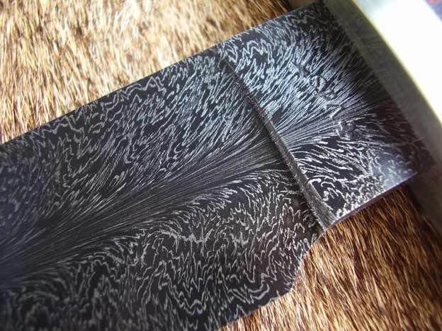

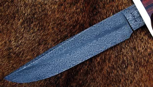

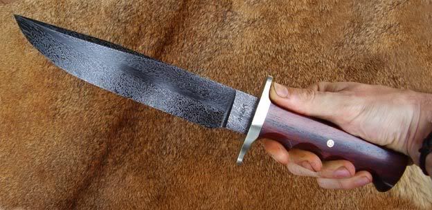

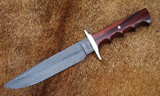

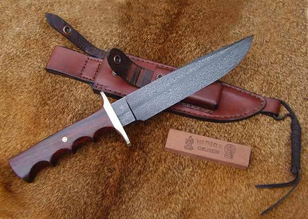

Hello gentlemen, are pictures of a piece inspired by the work of a pioneer of hand-made knives from which all of us once we were inspired.
The piece in question is a copy of the well known model Randall # 14 Attack.

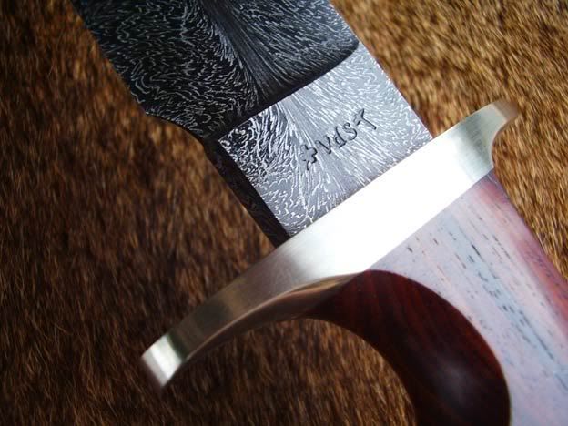

In our case the blade is hidden tang, flat style from the spine to the edge and made of pattern welded steel in feather pattern from a tight "W".
The ensemble was completed with a handle in cocobolo wood something more stylish than the original but without losing the essence, is very good wood, with alpaca guards 9mm thick and has a mosaic pin.

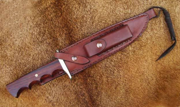

The sheath is leather tanning with 3mm thick, it made the pocket for sharpening stone which would have been better aesthetically smaller but at the time of use the 10 cm German stone we believe is best .
We wish you enjoy the photos.
Thanks for looking.
Saludos, Javier & Marcial. VdS.
