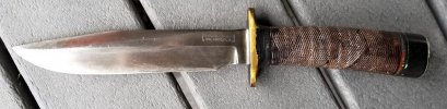

In another post https://www.bladeforums.com/threads/dont-flame-me-bro.1726793/, AtomicRooster57 asked if forcing a patina on a new Randall would get him flamed. I answered with a pick of a new (2020) Model 1-8 where I'd done that.
That made me think I should confess to other blasphemies. I cast no aspersions on Randall collectors who only admire and take care of their knives, even going so far as not putting them in their sheath. I think that probably covers 50% of the Randall buyers. Then there is the 40% who buy one to say they have one but are too fearful of reducing the value by using them. I'm in that last 10% of people who like to use their Randall knives and in fact modify them to better suit their needs.
My first Randall is a Model 1-6 that I bought in 1966 in preparation for Vietnam. Over the years I've shortened and blackened the guard, blued the blade, reformed the tip, beveled and blackened the butt and ridged and checkered the leather grip. I explained much of this in a Randall Collectors newsletter in Nov 2002 (PM your email and I'll send you a copy)

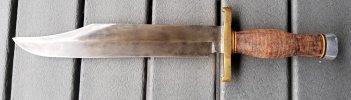

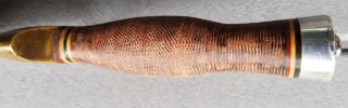

More blasphemy.
The worst thing about a new Randall from a user standpoint is the slippery leather grip. This can be cure by running it under hot water which raises "fur". I prefer to go one more step by adding ridges and checkering with a checkering file. This is a 1950's 12-11 Confederate Bowie I recently refurbished.

On the leather do you use a checkering file for metal or the checkering tools for wood?

Did I ever get a surprise Murindo. I've never used hot vinegar to force 01 Tool Steel. Needless to say it's a completely different finish than on 1095. She soaked of 2 hours and she came out almost gun blue! I wasn't expecting that. I like it but will hit it with some steel wool to try to knock down the gloss. I gave the hilt and but cap the scotch bright treatment.
Neither of my Randalls were what I call sharp so I put a mirrored polish edge top and bottom. Putting an edge on the top edge was a head scratcher but got it done. I still haven't wrapped my head around putting an edge on my #2. I'll cogitate a little longer before I give it a go. Another astonishment I received was how easy it was to sharpen compared to some of the super steels. It will take a very keen edge. Next week we will see the edge retention of 01 Tool Steel.
