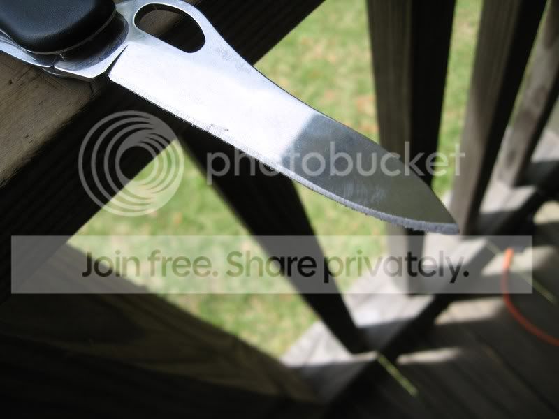

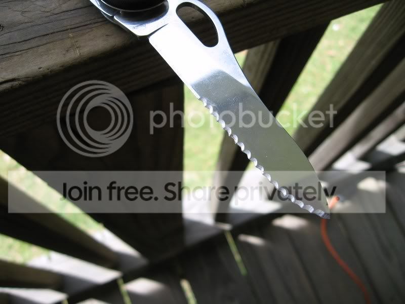

hey bear, Thanks to your pics I just ordered a OHT.... Can you tell me how you ground off the serrations? Is it convexed? I am gonna do that as soon as it arrives, figgured it would be an interesting project to pass some time.
It was real easy but then I sent another OHT to a guy to do it this time he did both sides. It is a chisle grind. He charged $20 did an unbelieveable job too.
I did mine with a course eze-lap and then medium and fine. The serrations come off real easy. I always liked them and they are the only serrations I have ever liked for whittling wood. You just might want to keep them. Swissbianco told me that there will be a red scaled OHT with a plain blade and a corky instead of the phil screw.

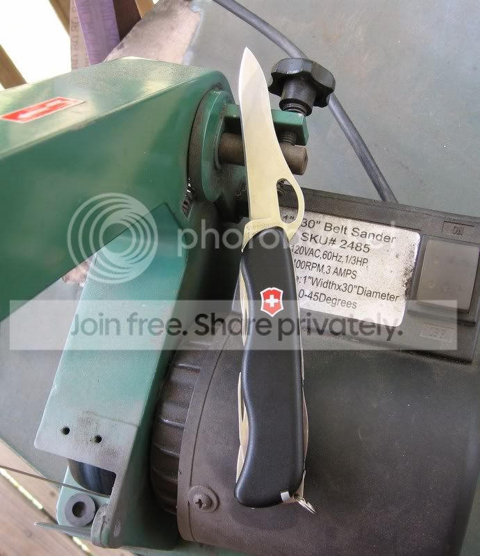

I need to sand the serrations off my OHT. That's the one thing I dislike about it. If I mess it up, no problem. I have a new one in the box.
I got out the old belt sander. Time to take off these serrations and put a fine edge on my OHT.
I started with 80 grit. It takes off steel in a hurry and doesn't seem to heat the blade as much as finer grits. But it looks pretty rough.

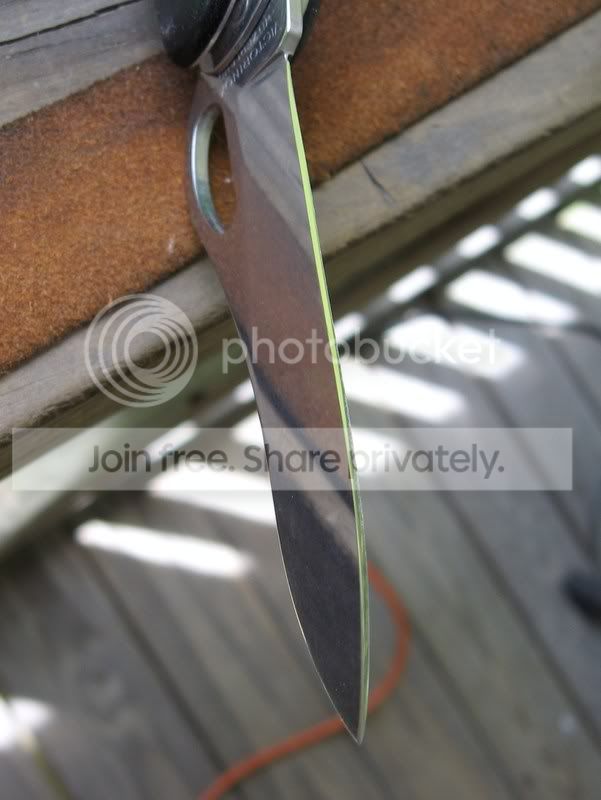

Then I went to 180, then 80 micron, and final finish with a 15 micron. It will shave the hair off my arm now.
It isn't abolutely perfect, but it works.:D
I did both sides. The blade was only ground on one side, even on the plain edge portion.
If it came out as good as it looks I say open up shop and take them on. Many people will want it done. Better someone here than on edcforums. Good stuff more pictures it is the ROCKSTAR!
