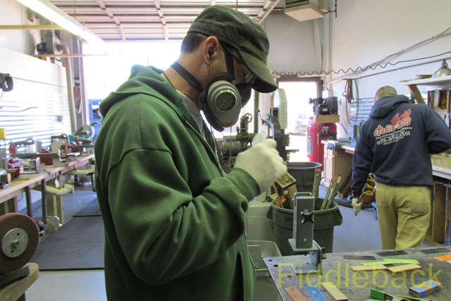

Morgan took this shot Monday morning. I was flattening the components that make up the bolstered scales. Karl does the layered scales, but the bolsters are a pita, so thats all me.

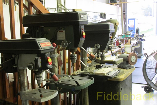

This is a view down the length of the shop showing the drillpresses in the foreground, and the grinder bench out towards the door.

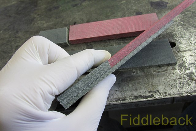

These are the parts for the bolstered burlap scales all ready for glueup.
This is the bolster to be. You can see the 12 degree angle where it intersects with the scales.

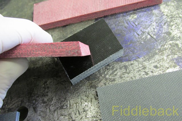

This one is a shot of the bloodred burlap scales with a supplimentary angle machined into them.
This is how it fits up.

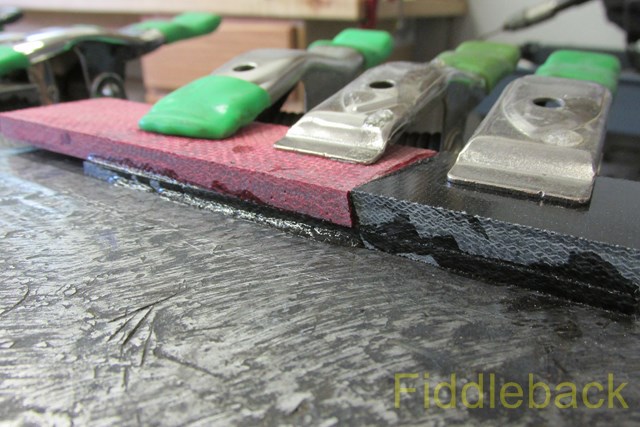

All glued up.
