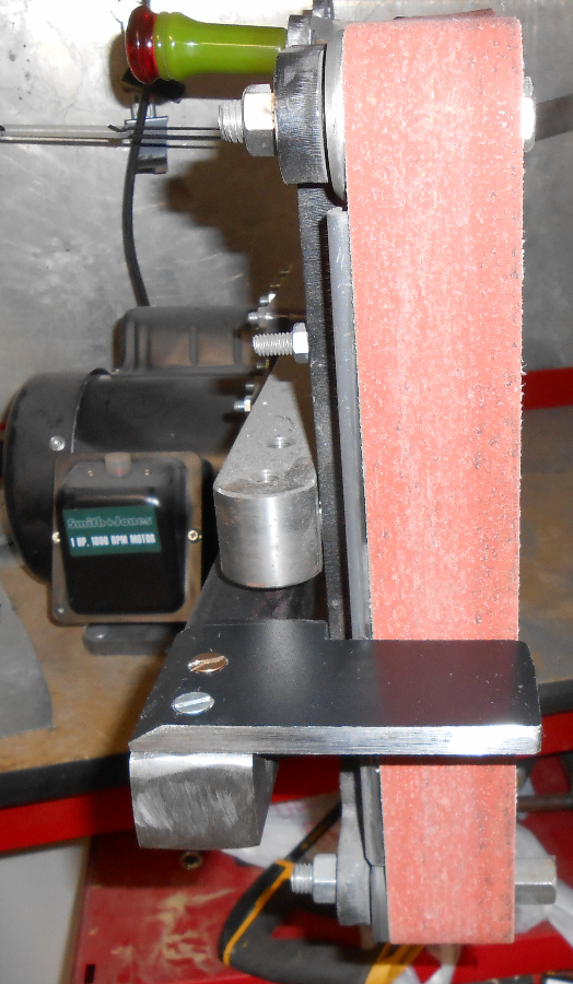

So until today I have done all my grinding free hand.
But after a couple of visits to Stan's shop, and seeing how his grinder was set up, I decided to make a tool rest for my grinder today.
looks nice and sturdy. beware of the blade getting sucked into the space between the grinder and belt :p . the toolrest really helps because i can push harder and the belt does not yank the blade downward. especially with wheels.
The steel used was cut from something that could best be described as a computer server rack stabilizer. It was a big heavy piece of steel attached to the bottom of a server rack to keep it from tipping over when the servers were slid in and out on their rails. I rescued it from a scrap pule because I often find uses for pieces of steel others consider trash. More than once something like that has been turned into guards or pommels for my knives. This time it served a more utilitarian purpose.

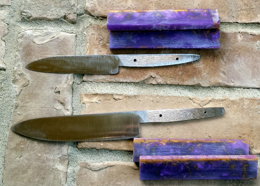

Here's a pic of the kitchen knives I'm working on (as the heat permits) for my wife. There have been some challenges already. For example, getting the holes drilled in the tangs. On both blades there was a hard spot that burned out several drill bits. I eventually used some diamond dusted Dremel bits to finish the job. You might also note that I've begun stamping the type of steel into the tang so I can tell whoever does the heat treatment what they are treating. In this case I'm using CPM S35VN.
The handle material is PolyPearl. I cut all the scales from a single block and now have two book matched pairs, but I'm not sure that matters, since the gold coloration didn't get thoroughly infused in the purple. We'll see.
Those look good.
You may want to consider stamping or etching the steel on the tang after you get it perfectly flat for the scales, otherwise you will end up grinding it off .
