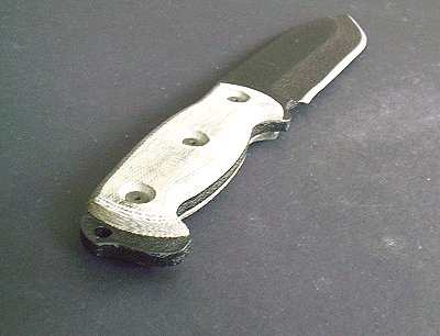

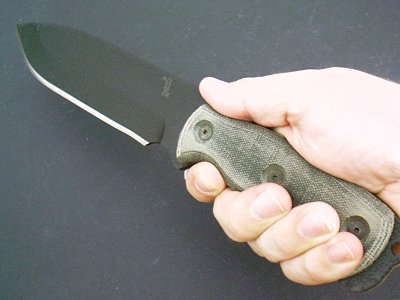

The micarta handle provides decent traction (though is just a little slippery when wet). Its contours make it quite ergonomic, at least in my grip, and I found it very comfortable over extended chopping and cutting. The protruding butt (which has a lanyard hole) has also held up well to my using it as a makeshift hammer. The only real wear and tear, other than dings in the edge and scars in the powder coating, has been seen on the allen screws holding the handle slabs to the full tang. These have rusted after protracted exposure to damp conditions (not to mention more than a few "rode hard and put away wet" storage incidents, during which the knife was unceremoniously dumped with my camping gear for a few days before I got around to cleaning and putting everything away for the next outing.
The width of the spine makes the knife suitable for pounding through wood to chop it, though of course this is abuse of the knife depending on how you view such things. The spear point penetrates well and exhibits a distal taper -- it gets thinner as well as pointier as you near the tip. The knife really excels as a chopper because it is so heavy. The knife and sheath together weigh one pound, 10.8 ounces on my postal scale.

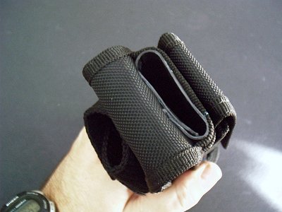

The Nylon sheath is a bit crude but perfectly serviceable, with built-in straps and grommets for lashing and a hook-and-loop retention strap on the belt loop. There is a pouch built in for carrying a smaller knife, sharpening stone, or other gear (I usually tuck a multitool in there).
I found myself wishing for thumb grooves on the spine of the knife, forward of the handle, but the choil helped compensate for this, giving me a place to put my index finger when choking up for closer work. The point of balance of the knife is right behind the choil.
