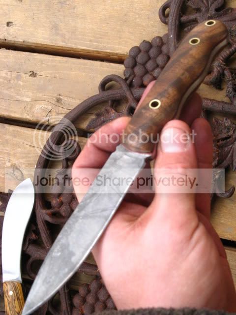

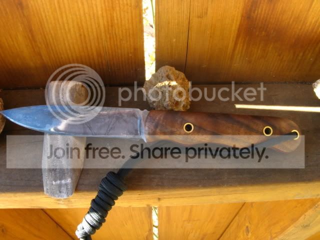

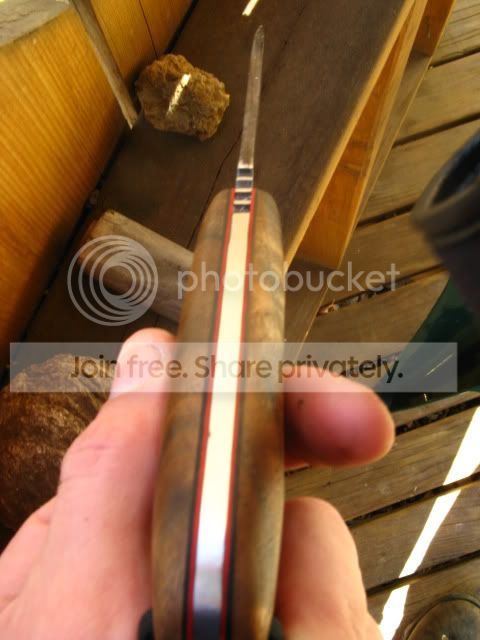

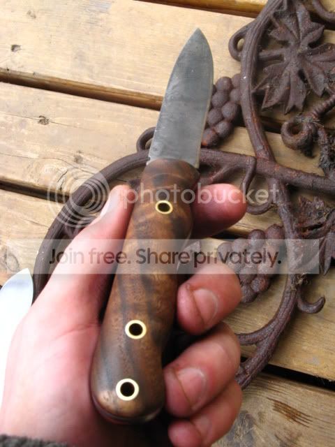

The homemade micarta scales on this guy were falling apart. The tang underneath the scales was all rusty as well. I had just enough claro walnut to give it some new scales. Pins are 1/4" brass tube and it has red/black liners.
This is before.
And after.
This picture kinda sucks.

Well done! That's a vast improvement over the "before" version IMO. That dark walnut just goes with the patina on the blade perfectly.
Very nice! Is it just me or does that blade have a really nice patina to it?!

Looks like a high dollar Bushcraft knife. Aurora/Woodlore combo. How does it do on shaving wood?

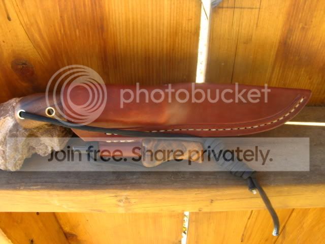

The blade is 5/32" thick. When I sent it to a friend for sheathing he reground the blade and convexed the edge. It is much sharper now than ever.

This one got my "Gutsplatter" etch. I prefer to add a little patina to my high carbon woods knives. I usually etch with ferric chloride, vinegar or sometimes mustard.
