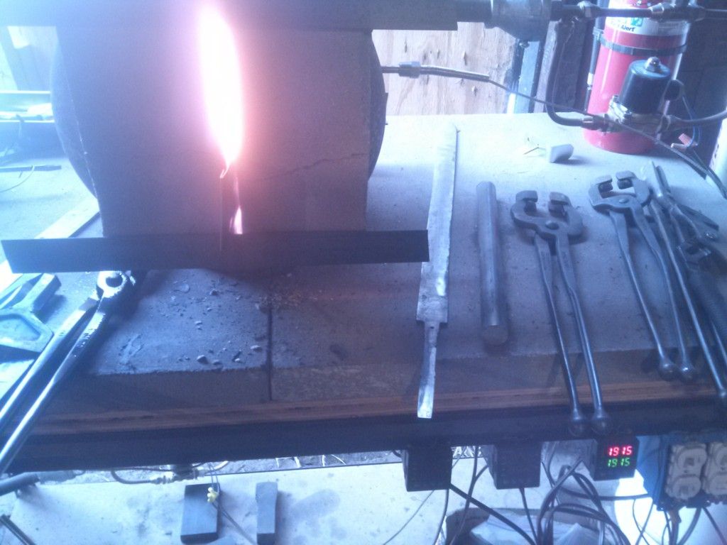

Got moved along to the handle layout and heat treat today.

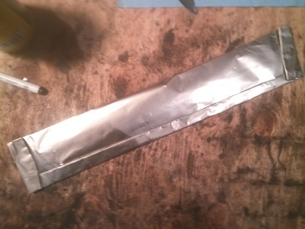

Foil wrapped.
Ran two stress relief cycles prior to austentizing
preheated to 1300, 1500, then soaked at 1915 for 20 minutes. ... shorter than my normal soak but as a big chopper I want to keep her a bit less than full hard...

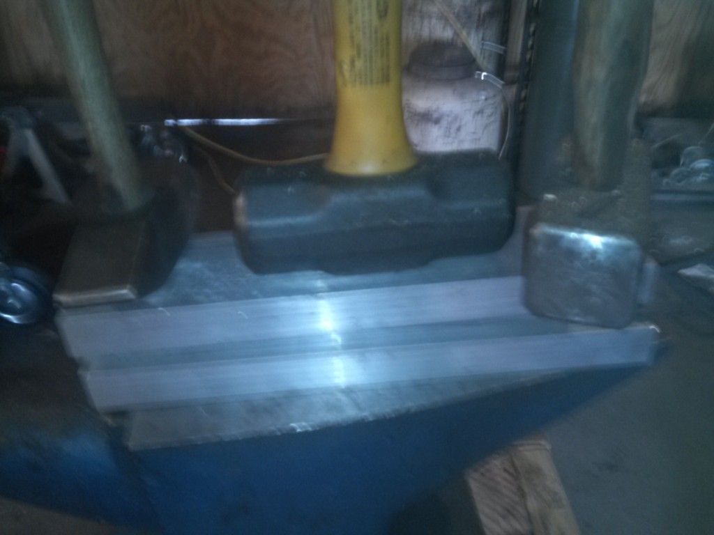

plate quenched.
Did an RC test as quenched at she came in just a shade over 60RC.... softer than ideal for a skinner or fine use knife but for this application exactly what I was shooting for.... To draw her down even more I ran a hot first temper at 500F for 2 hours... Follow-on RC testing showed her at 57RC, which is ideal in my opinion for a blade of this size and intended use....
Now in Cryo I expect she will gain 1 to 2 RC and I will finish temper twice at 400f to keep her at 58 to 59RC.

foil wrapped

plate quench

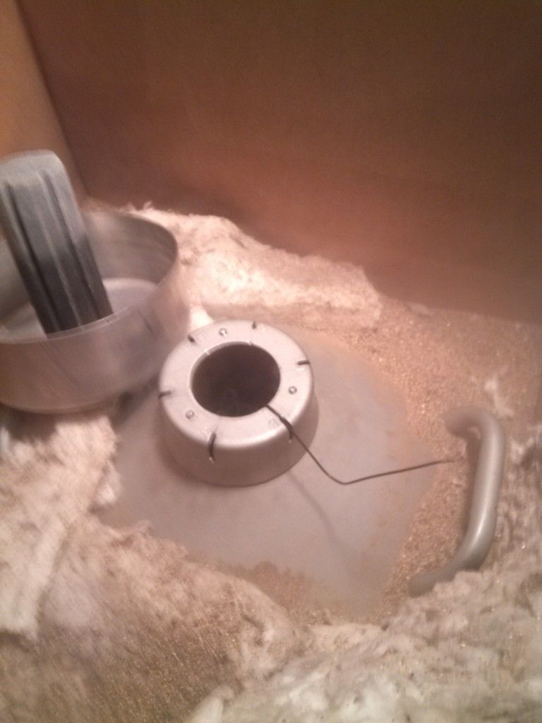

cryo

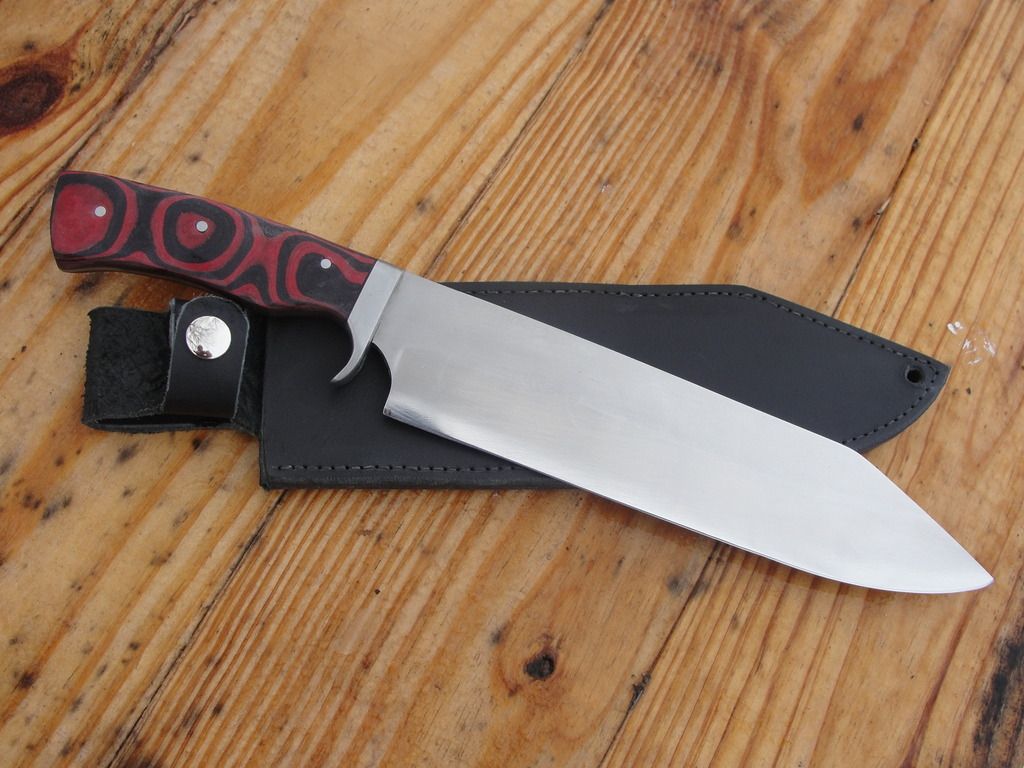

Thanks for sharing Atavist, I'm sure Rasco will enjoy his own customized hard use chopper, and from his sig line he apparently enjoys red and black, so the handle was a nice touch for him. Very nice of you to give it away! :)

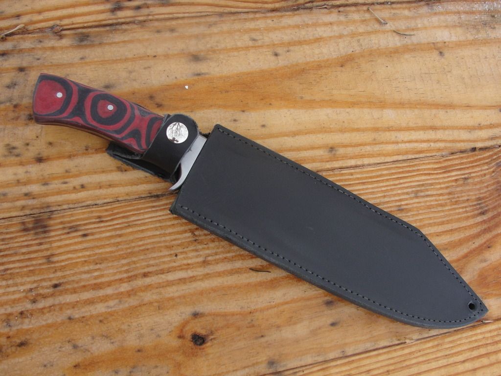

I already own several knives that can easily match or outperform anything Ontario offers, so when I got lucky enough for a chance to dream up any knife I wanted and have Jason make it for me, I decided on this. I expect this knife will outlast me and my son will get to own it and remember it as "Dad's big ass red & black bowie".
Maybe Jason will include a business card or something, just in case my son ever wonders where it came from or "what brand" it is :p

The handle pins should be centered, and as equidistant as possible.....a chopper should have a thong hole for safety....the choil/ricasso area is too small for a finger, but just large enough to ensure that a branch will get snagged in there if used for limbing....the clip point is neither sharpened nor does it have a swedge. These are just a few issues that stand out, looking at the photo.
There are makers posting first or second pieces that are STUNNING by any metric, and to post middling work HERE is probably not the best way to get a career started.
It's not ego speaking would like to see everyone get a chance at winning here, but the competition out there is soooo tough....
