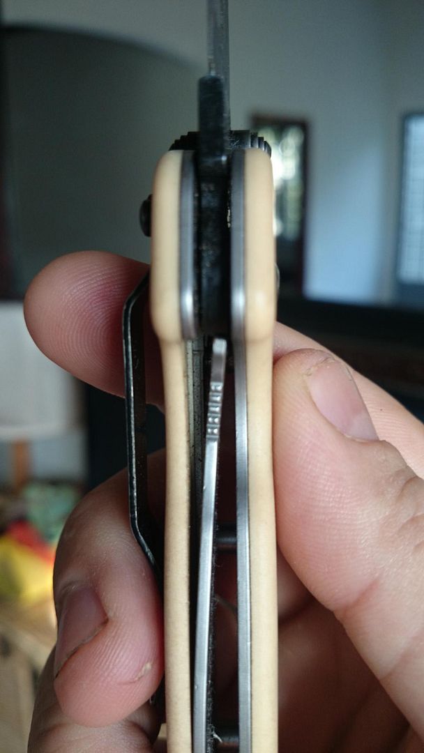

I bought a RAT 1 recently and yesterday needed to light a fire and had no axe so thought..perfect....I can try some batoning. Well...I was shocked at the poor performance of the lock mechanism. I was trying to split small kindling size pieces with relatively light taps and the lock was just not handling it. I know my knife is not made for this but I've seen plenty of YouTube videos where guys use the RAT for batoning without issue.
I should have made a video but it was just me so only two hands. One thing that might be the issue...have I bent the liner lock to far to the opposite side in using it for batoning ? See this photo:
To be honest I don't remember the position of the lock up before this happened AND the liner lock started failing from the moment I started batoning.

You have pointed to the reason it failed. Not many fixed blades will do that kind of work let alone a folder.
Assuming you didn't deform the face of the lock bar while batoning and there's no up/down play in the mechanism, there looks to still be some decent life left in that lock. Having said that, you can probably move the lock back over a bit by following the instructions in this thread: http://www.bladeforums.com/forums/showthread.php/1241043-A-repair-maintenance-question-for-an-older-knife.
edit: To clarify a bit: The lock may have moved over due to being flattened against the tang, or...It may have moved over due to the two halves of the knife being forced out of alignment with one another. The latter situation is definitely fixable via the method in the link. I can't say whether it will work if the lock bar has been damaged. :thumbup:
