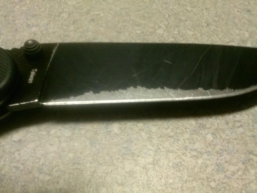

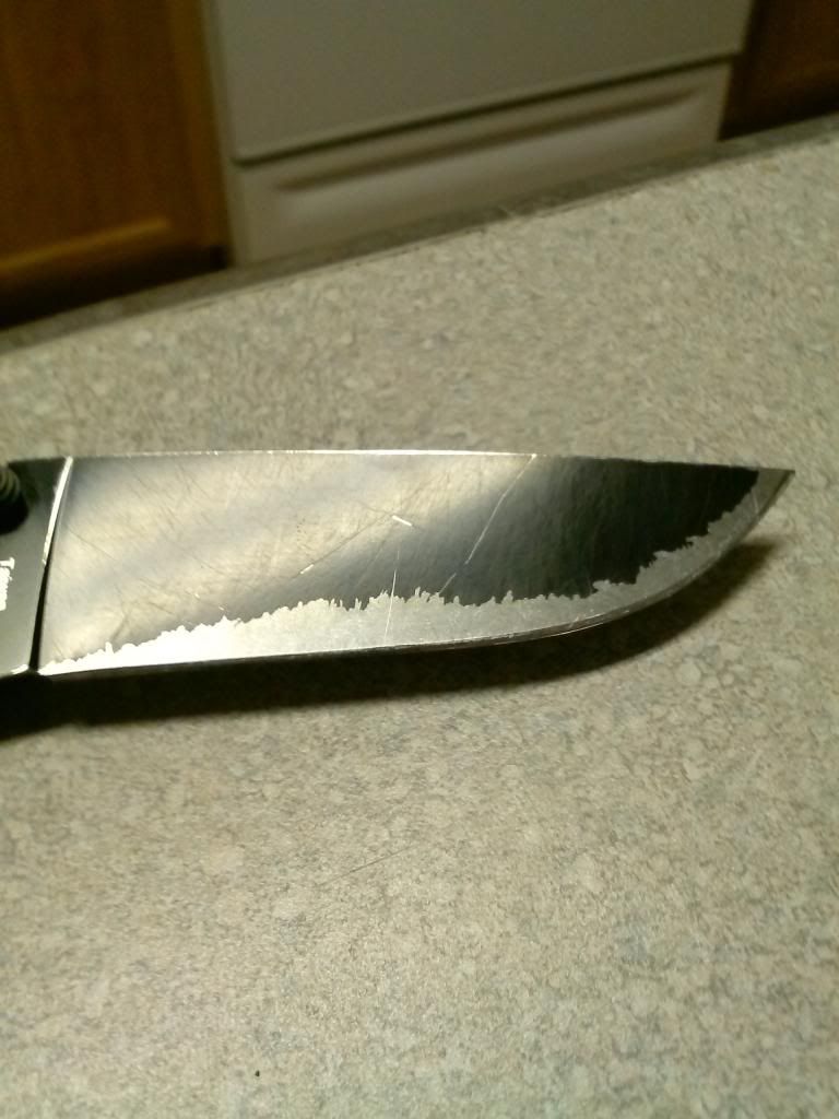

The results: The edge dulled but never to an unusable point. It became VERY difficult to make clean cuts due to the buildup of tape adhesive on the blade (as to be expected) so i had to wipe it down with Adhesive-removal wipes a couple dozen times. The paint wore off but held up much better than i was expecting. The blade seems to be stonewashed underneath the coating and looks pretty badass with this wear. (pictures below) I found that the lockup became a bit later which was odd because the hardware has Blue Loctite on it. After doing a bit of tweaking i found that tightening the pivot on the right-hand carry side down very well and then lightly tightening the other just fractions of a turn until it opens well for you causes the lockup to return to normal (40% as opposed to the 60% it was before). It's still just as smooth as when i pulled it out of the box. There are no hotspots on this knife during extended use and i never felt uncomfortable using it aside fro my thumb being sore from deploying the blade hundreds of times.

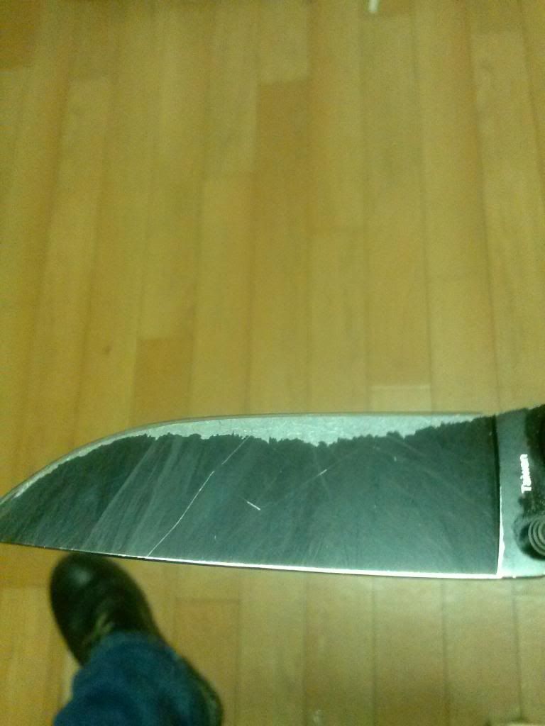

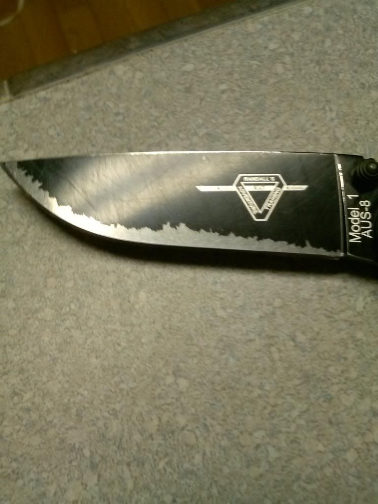

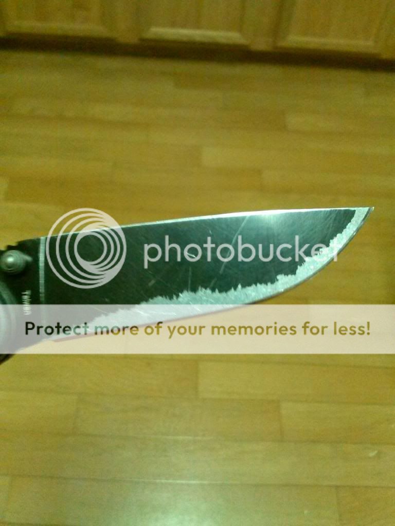

The pictures... after cleaning the adhesive off and before freehanding it back to hair popping sharp:

Glad you guys liked it. It looks like there's a stonewashed finish under the paint, i've never seen that before and it looks pretty damn cool.

That looks great where the paint wore off, use it a little more towards the tip to get it even and it will look like its supposed to be that way.
That's a great idea, killer. I tried to use different parts of the blade while cutting to see how it all performed and to make it not wear too much in one spot. I've got another few boxes left, i'll use this tip and see how it wears.

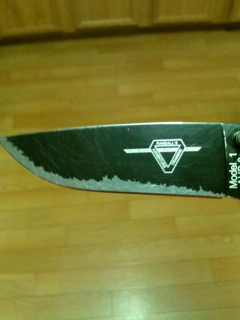

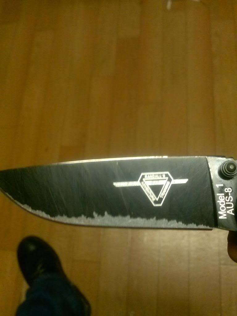

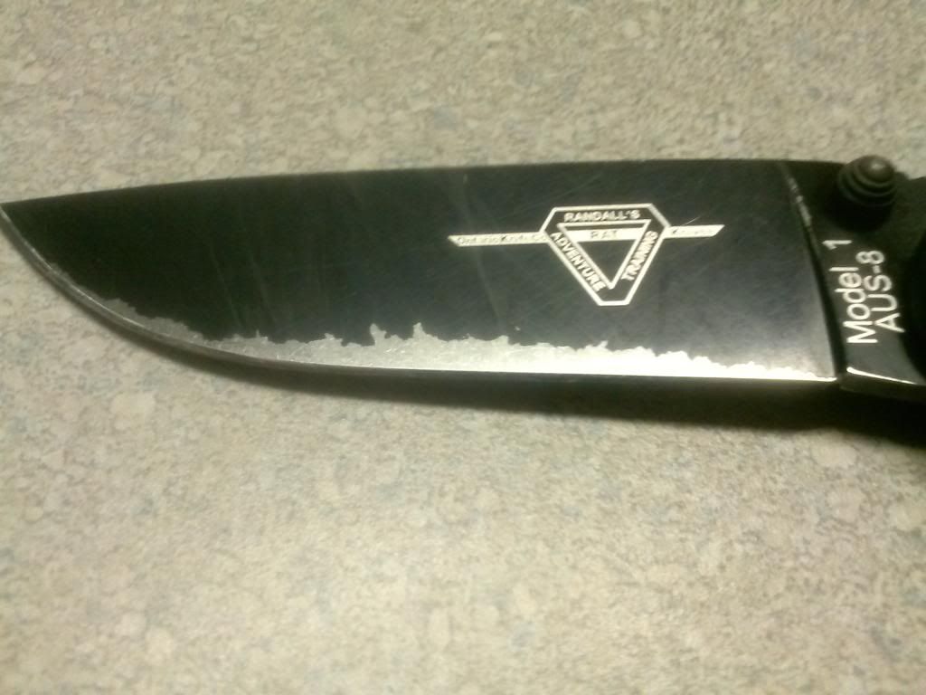

Anyway, day 2 update. Cut up about a dozen more boxes, used mostly the belly and tip of the blade and i think the finish wore pretty well. looks badass, in my opinion anyway. What do you guys think?

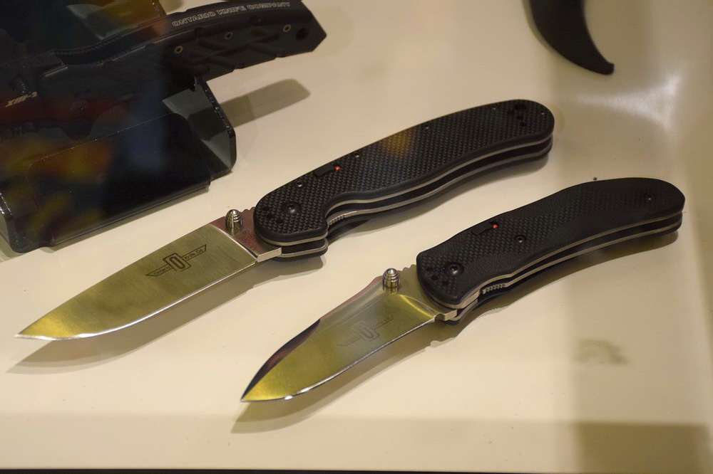

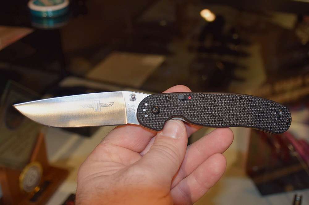

If I remember right, the scales were just the same nylon as the current RAt-1, but it does have assist:
The pictures are from last month's SHOT show in LV. I've being told that it's going to be released "...in a few months" price would be in $50-80 range...
I cannot wait for it...
