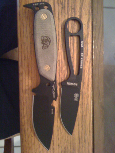

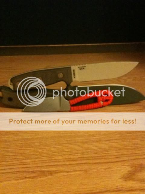

My HEST with my buddy TheNocko's birthday present, sorry for the poor quality.

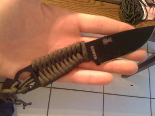

And then with my crappy first try wrap job (super loose)

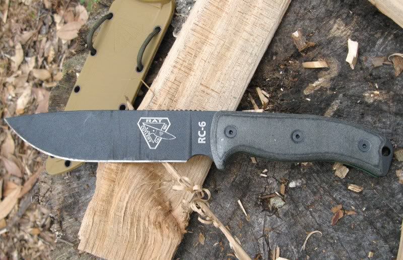

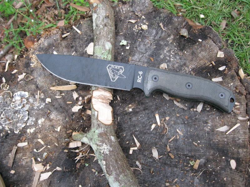

Here are my RC-5 and RC-6. The short Spec-Ops Navigator sheath fits the RC-6 perfectly.

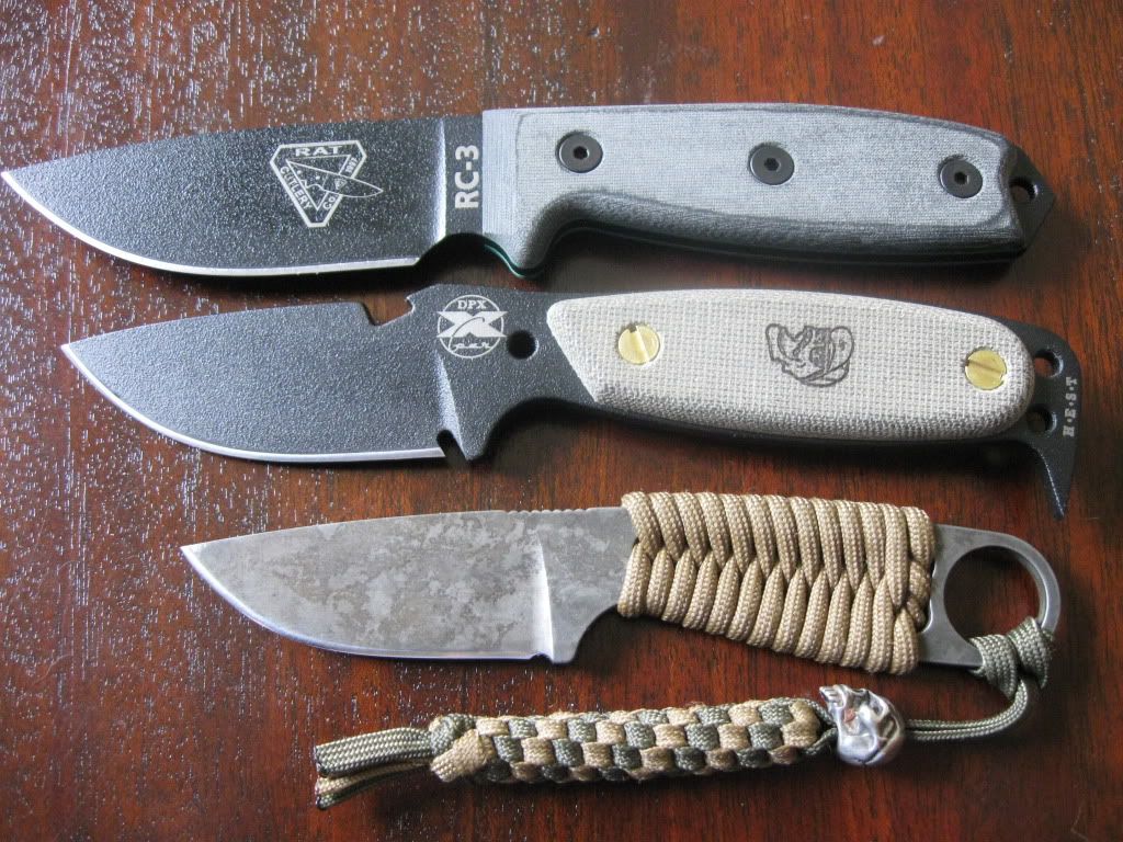

Some more RAT pics:

Horn Dog - Thanks for the pics of the HEST without the handle and the matches inside. Does a good job of showing the size of the compartment. One question, does the spec ops sheath that the rc6 is in have a snap in addition to velcro on the handle strap?
Yes, the keeper strap is adjustable and it does snap on. Mine fits like it was made for the RC-6.

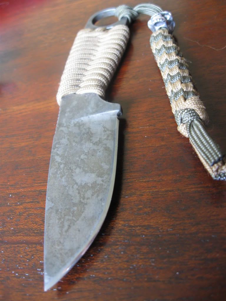

That looks very nice. Did you just use vinegar/mustard?
Stripped with paint stripper. I evidentially got the wrong kind because 48 hr soak still required 2 hrs of scraping. She did not want to give up her coating!
I sanded with 2000 grit wet/dry paper.
coated it with plain yellow mustard and wrapped in paper towel (PT) to give it some texture, unwrapped and hung by hole for about 1 hr.
cleaned knife with soap and water and soaked a paper towel in red wine vinegar wrapped the knife in the PT for about an hour.
cleaned and reapplied the mustard from original PT by then it was partially dry which gave it that blotchy patina let it hang for about another hour.
cleaned and coated the blade with potato juice, heard it would yield a bluish patina but I really noticed no change.
cleaned, oiled , stroped , and wrapped.
sorry no pics of the process, but I have seen some good ones in here.
